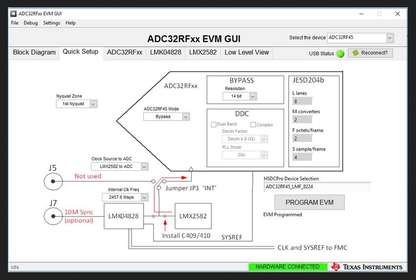

  • Neeraj,
    What the customer is looking for is the following:
    "What I need is an example project that uses the internal clock instead of the external clock. If I could go through an example using configuration files that are known to work together (There are two and I don’t know which pairs are compatible for my board with C409/410 installed), then I could confirm whether I really have aq problem or if I just have not configured the device properly."
    Thanks for your help with this!
    Richard Elmquist
  • Richard,
    Have the customer follow the attached example. This currently works with the TSW14J56EVM. For the case when using this with the KCU105, they may have to change a clock divider setting in the LMK output clock tab. Make sure they move C431 and C432 to C409 and C410. This is on the bottom of the board near the LMX device. They also need to move the shunt on JP3 to pins 1-2 (INT). This setup will have the ADC sampling at 2.4576Gsps.
    Jim

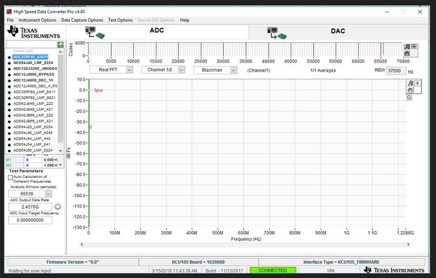

    On my version of High Speed Data Converter Pro v4.80, it is not possible to set up the Quick Setup as shown in the power point you sent me. The reason is that my choices in the ADC Select box only has one option for the ADC32RF45. You want me to select ADC32RF45_LMF_8224. But my only choice in the drop down list is ADC32RF45_42810, which doesn’t work.
    I tried to update the GUI software, but it says it is already up to date. How do I get more than one choice for ADC32RF45 configurations so I can select the one you suggest? (There are several choices each for other ADCs in the drop down list)
    I have attached some screen shots so you can see what I’m doing.  The first picture shows my settings in the EVM GUI.  You can see that this exactly matches the Quick Setup Tab settings that were in the power point you sent me.
    The second picture shows the HSDC Pro screen where I am trying to select the correct ADC configuration from the drop down list.  You can see many options for other ADCs but only the one I have selected for the ADC32RF45, which as I pointed out, does not work for the settings in the EVM GUI.
    I hooked up my 32RF45EVM board to a TSW14J56 board and configured as shown in the power point presentation and it works just fine.  I have lots of choices for selecting the ADC, including the one shown: ADC32RF45_LMF_8224.  The problem is that when I hook it up to the KCU105, I only have one ADC option: ADC32RF45_42810.
    I either need updated firmware that will allow me to select other device options, or I need instructions on how to configure the device for ADC32RF45_42810 using an internal clock.
     The fact that there are no other options available for the KCU105, makes me wonder if anyone has ever used the KCU105 with the ADC32RF45EVM in internal clock mode before.

  • Richard,
    I am working on getting my KCU105 setup running but not there yet. I did find an ini file that the customer needs, but I am unable to verify it until I get my system running. You can pass this on to him to see if it works. Have him place it in the following directory:
    C:\Program files(86)\Texas Instruments\High Speed Data Converter Pro\KCU105 Details\ADC files
    Jim

    Can you verify the customer moved the caps to C409 and C410 on the ADC EVM? Also in HSDC Pro GUI, have them click on the "Capture Options" tab at the top of the GUI, then select "Capture Options", then set the # samples (per channel) to 32,768.
    Jim

    We are required to use the internal clock – not an external clock. Can the engineer modify his instructions to use the internal LMX2582 as the clock source?
    What is the purpose of the interposer card between the ADC Eval board and the VC707?
    What do you use as your source for the external 2.2GHz clock? Is there a manufacturer/model number we should get?
    I have the instructions, but I cannot find the code to load on the VC707 for this demo. Please provide the link ASAP. I’m ready to start testing.

  • Richard,
    Answers below
    Move JP3 to pins 1-2
    This allows HSDC Pro GUI to load the FPGA firmware and read and write from the FPGA using the USB port on the interposer board.
    We use a Rhode & Schwarz SMA 100 signal generator.
    In the HDSC Pro Gui, the ADC32RF45 modes available when selecting the ADC are 8224 and 42810.  But for 12-bit operation, we need 82820 mode.  Can you please provide the ADC32RF45_82820.ini file for the KCU105?
    ini attached.
    Jim

    I have made some progress, but I am stuck again trying to build the .svf file from the firmware.  Here is what is going on.
    1. I am successfully capturing data from the HSDC Pro Gui through the VC707 and TSW14J10EVM.
    2. When I select the ADC in the HSDC Pro Gui, it asks me if I want to update the firmware for the ADC.  If I answer yes, it automatically programs the FPGA by downloading the file located at: “C:\Program Files (x86)\Texas Instruments\High Speed Data Converter Pro\14J10VC707 Details\Firmware\TSW14J10VC707_v2p8.svf”.  This file works great.
    3. You told me in the email below that the firmware source code for this project could be downloaded from the TSW14J10EVM product folder on the TI website.  I downloaded this firmware and built it using the build_it.tcl file in the “scripts” folder.  It successfully builds the bit file “…prj_VC707\prj_VC707.runs\impl_1\top_level_block_wrapper.bit”.
    4. In addition, although the script does not build it, there is a file VC707__2_8_000.svf” file in the “SVFs” folder in the project.  I have manually downloaded it to the FPGA and it works just as well as the one that is automatically downloaded from the HSDC Pro folder.
    5. My problem is that when I build a .svf file from the top_level_block_wrapper.bit file, it does not work.
    I need your help in how to build the .svf file from the .bit file so that it will work just like the .svf file that comes with the project.  Here are the tcl commands I used to build the .svf file that doesn’t work.

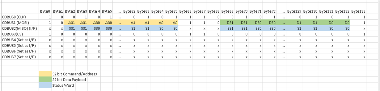

    FTDI CDBUS for Command Write/Read in TSW14J10:
    You need to set the low speed SPI port (CDBUS) of FTDI in Synchronous Bit bang mode before sending data. Below FT functions needs to be called for that.
    • ·         cFT_InitUSB(ftHandle)
    • ·         FT_SetBitMode(ftHandle,0x0B ,0)
    • ·         FT_SetBaudRate(ftHandle,1200)- We are setting the baud rate as 1200
    To send command data over this port, you need to frame a packet of bytes to be played on the port such that CDBUS0, CDBUS1, CDBUS2, CDBUS3 will act as  CLK, MOSI, MISO, CS respectively as shown in the attachment. And You need to use FT_write function to write the bytes.
    Please refer Synchronous bitbang mode in FTDI datasheet for more details.
    Command data format in TSW14J10:
    Two 32-bit word transfers are required per control write. The first word constitutes a 32-bit register address and 2nd word constitutes 32-bit data. The list of command and the packet structure for writing a command and reading the status for TSW14J10 is explained in Page 13 of "JESD204_TI_reference_design.pdf" document. This can be found in "TSW14J10EVM Xilinx Firmware Source" under TSW14J10 TI product page.
    The below source files from TSW14J10 Board dll explains clearly about the implementation of slow SPI interface for command write & read. Is it ok to share these files with customer?
    1. cFT_InitBB.c    - Explains how to set FTDI in Bitband mode.
    2. Write_Register_U32.c  - Frames the command data to be sent to TSW14J10.
    3. Config_Register_Write_Read.c - A wrapper to cFT_Write_Read_BB
    4. cFT_Write_Read_BB.c - Explains how to send & read data through bitbang mode.
    5.  rsConvert_Data_to_BB- Converts the command data to Bit bang data as I showed in the table attached.
    Jim
