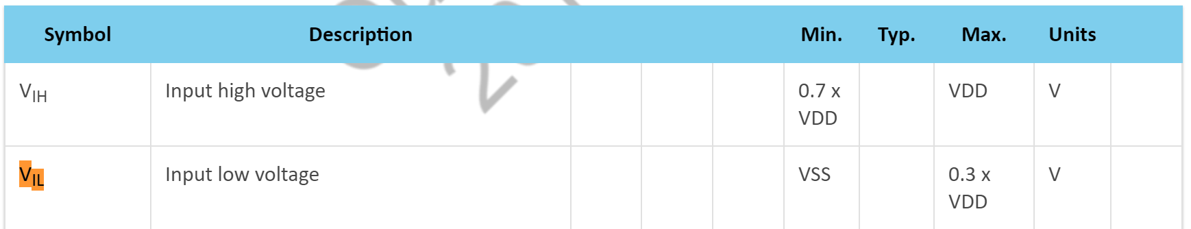

  • Hey Tom,
    CLKSEL is just tied high for now from the GPIO from the NRF with the plan to tie it directly to 3.3V in the future. The NRF outputs are attached below from the spec sheet, but I am observing about ~0.2V for OL and 3.3V for OH.
    For normal operation, START, /PWDN, CLKSEL, and /RESET are all pulled high. As I mentioned before I have followed the startup procedure detailed in the data sheet to appropriately toggle those pins differently during the startup phase.

  • Hi Tom,
    I've resolved the issue, the CLKSEL pin was indeed being correctly toggled in my Software, but evidently the GPIO I was using on the nrf was reserved and would never go high. Once I switched to a different GPIO, the ADS started working. Thanks for all the help!
