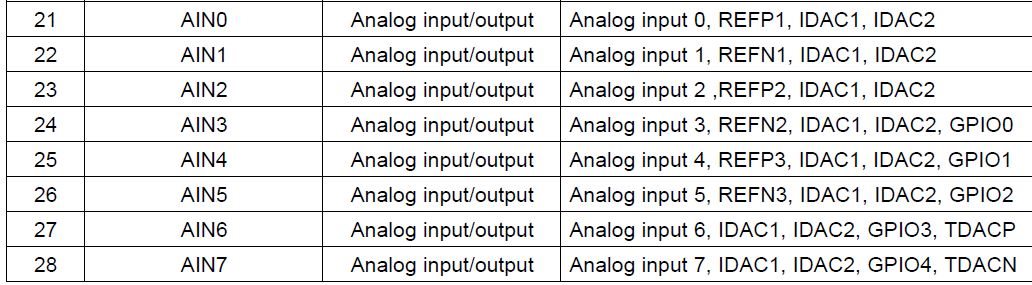

  • Humm, it appears I am more confused now...
    I have an external reference voltage of 5v (Am I supposed to be using AIN0/AIN1 as the reference voltage? if so, AIN is a very confusing label)
    The REFMUX register is defaulted to internal 2.5v, but when I set the REFMUX to the "internal analog supply" (which is confusing because isnt that the external analog supply?) I managed to read "something" from my loadcell, which was connected to the external 5v source and across AIN0/AIN1. That "something changes with load, but the value is way negative. -1150000000ish
    For now, I am only trying to sort through the 4-wire loadcell configuration.
    Do I need to set the IDAC registers to output on the AIN lines?

  • Hi spanky,
    The ADS1262 input pins (AINx) are multi-purpose. All of the AINx pins can be configured as an analog inputs, all of them can be used as IDAC outputs, some can be programmed to be reference inputs, some can be used as GPIOs, and AIN6/7 can even be used for the internal test DAC output. The Pin Functions table shows which functions are available on each pin:
    Correct, the reference MUX's "internal analog supply" is the IC's analog supply (AVDD - AVSS), as shown in Figure 77 of the datasheet. Even though you using the same 5V source for the analog supply and the load cell excitation voltage,  I would still recommend using AIN0/AIN1 as the reference source, as this is likely closer to the excitation voltage across the bridge, and in the case of a 6-wire bridge will give you the best ratiometric matching.
