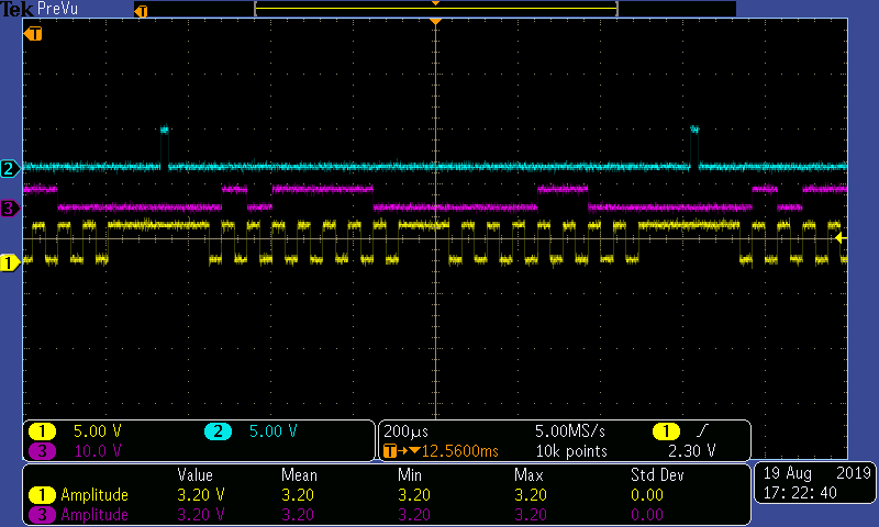

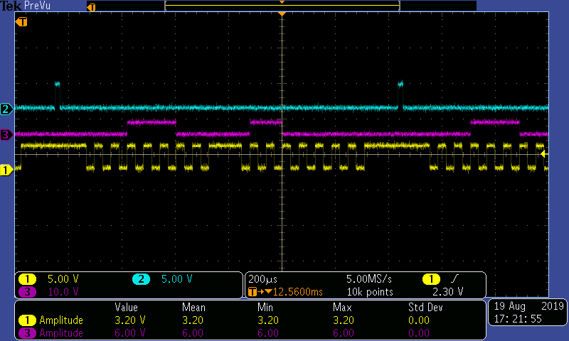

When I was writing to DAC102S085, for example I write a word 0x5E1C to set DAC_B to output a voltage, the value is shifty, not stable.
Next is my program and waveform.
Please help me how can I resolve it.

  • Hi Daojia,

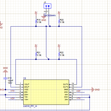

    Thank you for your query. The SPI waveform looks fine. Although a zoomed-in version will help analyze the timing better. I am assuming that some other circuit is pulling the output low periodically. It might be pulling either the DAC output or the reference input.
    Could you please share the DAC part of your schematics? If there are confidentiality issues, we can take the discussion to email.

  • Hi, Uttam
    The DAC part of my schematic as below:
    The function of DAC102S085 is just used to generate two threshold voltage about 3.7V(DAC_A) and 4.2V(DAC_B).
    Then use 3.7V and 4.2V to be as the comparing voltage in LM339 as below:
    I just want if the two input voltage at 5,6 and 7,8 pin is in the range: 3.7V~4.2V, the out ping will pull up to 5V.

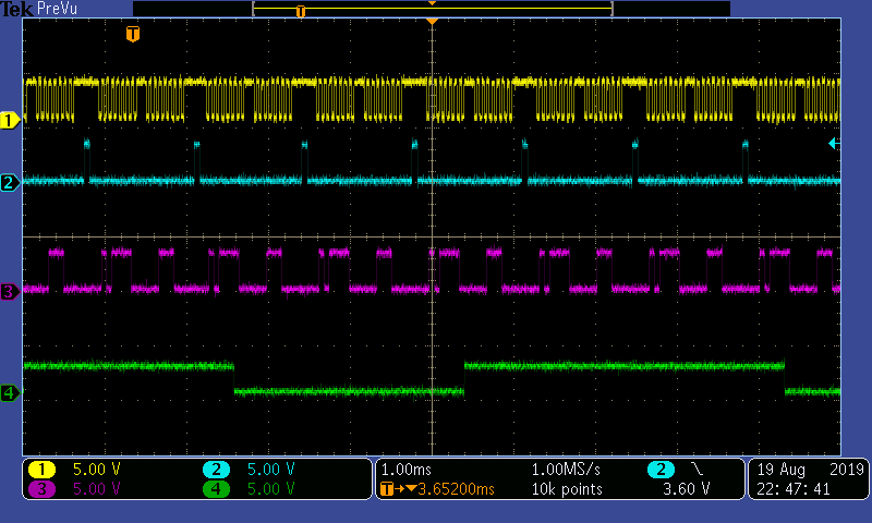

     A zoomed-in version picture is below: the first picture is writing 0x1C60 to DAC102S085.
    The second picture is writing 0x5E0C to DAC102S085.
    When I was detecting the output voltage of DAC102S085, it didn't equal to the value I want set.
    Daojia

  • Hi Daojia,
    Apologies for the late response. Is it possible for you to change the SPI mode to mode 1 and try? This is currently in mode 2.
    Uttam
