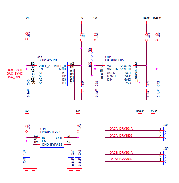

DESIGN:
  • C48 - Changed to 1uF.
  • C31, C42 - Changed to 1500pF
ISSUE:
  • J72, J73, J62, J51, J50 - Shunt Jumpers ON
  • J53, J60, J34, J32 - Shunt Jumpers OFF
  • Under this condition the O/P at J73 in this particular board is 5.010V. We see the following on J53 & J60 on the chipside:

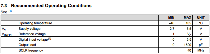

  • DAC I/P voltage range according to datasheet:

    Also, you have 0.1µF capacitors on the outputs of the DAC, while the maximum load capacitance of this device is specified at 1500pF.  I wonder if the output is oscillating and possibly causing issues.  Please try removing the capacitors and seeing if the performance changes.

    Here are locations where the scope shots were taken in the schematic:
    • DAC-SCLK: J63
    • DAC-SYNC: J64
    • DAC-DIN: J68
    • DAC-OUT2: J60

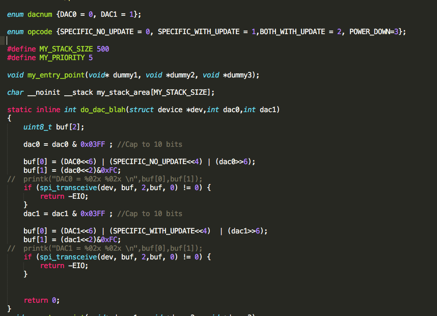

    I don't see the waveform when the output is problematic. The DAC output looks fine in my opinion. Could you tag the waveforms for better understanding if I am missing something? Another point is that in the DIN packet you are selecting DACA. However, you are monitoring DACB. Could you please clarify? I also couldn't correlate any power supply change to any waveform. Please try to tag them properly.

    1)The red line is the output of DAC2.  ( I believe your observation about the DACA vs DACB is incorrect - the code is such that we first write to dac1( without updating the output), then write to dac2( with update of both outputs).  Page 16 of the user manual ).
    2) DAC1 and DAC2 are both driven with a sawtooth waveform, offset in phase by 90 degrees.
    do {
            for( i = 0 ; i < 1024; i+=50) {
                   spi_slave_select(spi_dev,1);
                   do_dac_blah(spi_dev,i,(i+511));
                   k_sleep(10); //Yield for 10 ms
    } while(1);
    3) The expectation is that the sawtooth value ( i.e output of DAC1 and DAC2) changes FOR EVERY invocation of do_dac_blah(...).
    4) For a voltage level under 5V, we see a nice ramp that updates at each (pair of) writes, as expected. At voltages above 5V, that ramp is no longer smooth - i.e., there are missing updates. NOTE THAT THERE IS NO CHANGE IN CODE OR HARDWARE BETWEEN THESE TWO EXPERIMENTS - the only change in the voltage being fed into the chip, as well as the IO voltages.
    5) Note that our schematic is slightly complicated ( by the fact that we drop a 6V to 5V, and then convert the microprocessor's SPI IOs to the same 5V). I am not certain if that could explain this behavior, but I am mentioning it so you take note of the fact.
