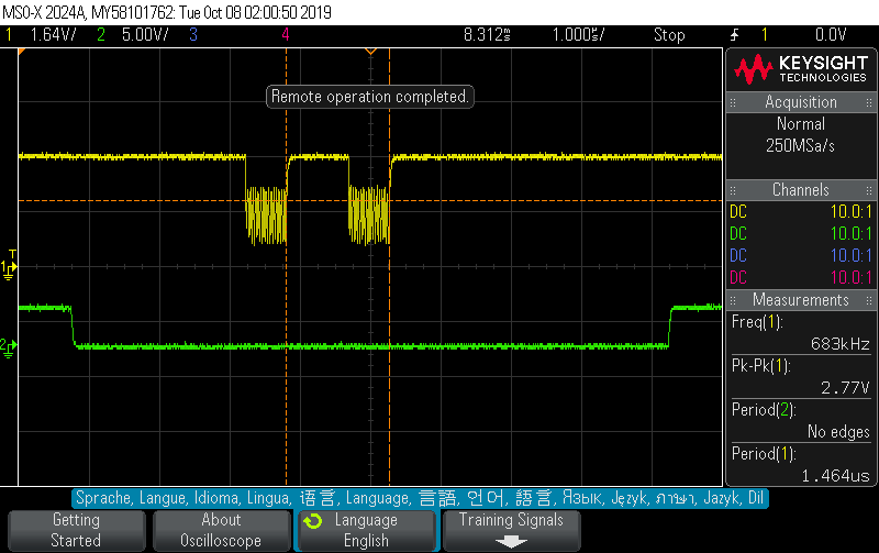

I have an external 12 bit ADC (ADS7886) on a custom designed PCB with SMT32F767. This ADC interfaces with the microprocessor with SPI. Now my problem is that I couldn't read digitized values correctly. Maybe because of the incorrect driving of the ADC or setting of SPI. Based on the ADC datasheet, I should set ADC SCK as 20 MHz, but I couldn't do that with the SPI. Because I can set only either 13.5 Mbits/s or 26 Mbits/s baudrate with the SPI (with more than 1Mbits/s clock setting, the clock signal is distorting like not exact square shapes). So how can I correctly drive ADC and read the digitized values?

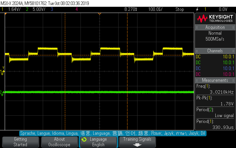

I have attached the results with figures:
ADC input analog signal with yellow biphasic square waves.
ADC SCK signal with yellow plot and ADC CS signal with green plot.
ADC SCK signal with yellow plot and ADC SDO signal with green plot.

    This device can only work with a max 20MHz clock. It will not function properly if the clock is at a higher rate than this.
    If you cannot provide a clock that meets deice requirements, then the device will not perform correctly.
    You should be able to use the 13.5Mbits/s, but this will limit the sampling rate of the device.
