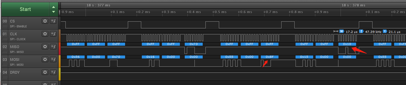

    We use the microprocessor GPIO port to simulate the SPI operation ADS1241. After the register value is written by the WREG command, then the RREG command is used to read the same register value. The register value of the operation is not successfully written.

    One thing that is still not clear.  Is the micro you are using also powered by 5V?  I also find it interesting that the data example you showed starts with byte 1F and ends with byte 1F.  Do you have updated Saleae plots of the communication that you can share?
    When sending commands, there must be sufficient time for the command to be decoded and a proper response loaded  before attempting to read.  See the timing diagram on page 6 of the ADS1241 datasheet.  In particular notice the t6 timing.  You must make sure that you have allowed sufficient delay between the RDATA, RDATAC, RREG and WREG commands before the next set of SCLKs are set in the transmission sequence.

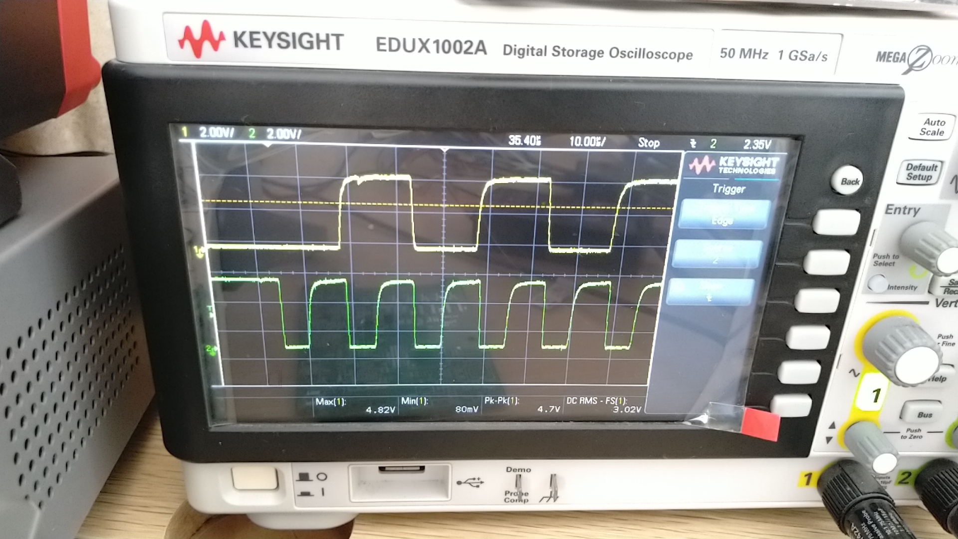

  • Hi user6216951,
    There appears to be some possible SCLK glitches based on what I see with the middle byte of the RREG of the DOR registers.  I would highly recommend observing the communication using an oscilloscope and observe the rising/falling edges of SCLK to see if there is a spurious SCLK or perhaps a non-uniform clock where there is significant differences in the duty cycle for high and low time.

        We used an oscilloscope to capture the waveform of the IOCON register command captured on the SCLK and Din pins near the ADS1241.
        The following figure is a partial enlarged view of the starting part

    I apologize for the delayed response due to an extended holiday weekend in the USA.  If you set POL to 0 or to 1, you should see similar results as the data will change on the first edge of SCLK and should hold steady on the second edge of SCLK.
    There will be some differences with respect to going through isolation.  When writing to the ADS1241 both the SCLK and MOSI will be delayed by the same amount.  However, when reading results or register data, the command will be clocked with the same phase as SCLK, but the reading of data will be delayed by an additional delay through the isolation when returning to the micro.  The micro sending the SCLK will not consider any delay at all and can potentially clock in the data prematurely.  So the ADS1241 will have the SCLK and MOSI delayed by the isolation, and the micro will have an additional delay of MISO because of the isolation on the return path.
    In the latest Saleae plot there is what appears to be a spurious SCLK. Notice the data transmitted from the ADS1241.  The MISO transitions on the rising edge except for the last MISO going high.  This occurs slightly after the 6th SCLK of the byte being transmitted.  Notice that the earlier transitions are taking place on the rising edge, but this last transition does not.  Something is interfering here.  I have mentioned this previously in response to your post from 11/25/2019.  You need to consider both the transmission delays, and any spurious SCLKs on the signal paths.  This could be due to wiring issues or poor grounding.
