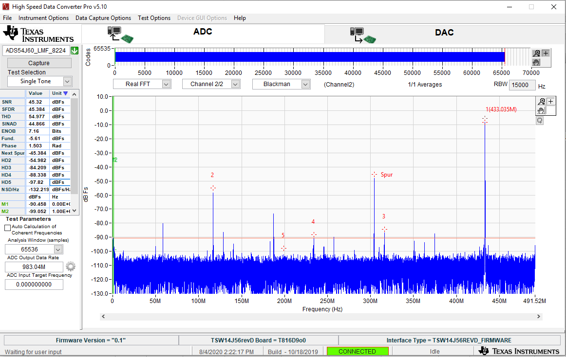

    1. I set the signal generator to 550MHz. I did not use any filter at the signal output. I see difference results between Ch A and Ch B. (i get ~6dB difference in SNR FS).. I attach the pictures. Can you explain why.

  • HI Jim,
    1. I did the write '1' as mentioned in the data sheet but when i read the register i read the same value that i wrote (it means that this bit is readable) so i am not sure  that i wrote correctly to register 6A0012.
    2. In addition, i do not see any change in the eye when i run it in the "serdes test option"
    Yuval

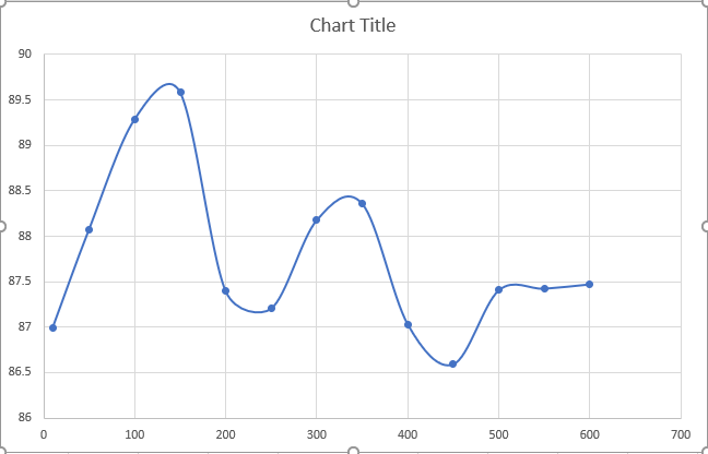

  • Hi Jim,
    I am trying to measure the ADC BW but the results i get are weird. this is what i did:
    1. The frequencies I measured were from 10MHz up to 600MHz.
    2. Each frequency, I first measured on Scope (just the signal generator + cable). The scope is 2GHz BW, 10GSPS.
    3. Then i measured the full set (signal generator + cable + eval board) by the HSDC tool
    4. The results i got from (3) I reduced with the results i got from (2) and converted to dB
    5. I attached the excel file with my measurements
    6. Looks like unstable results (see below)
    7. can you tell me what have i did wrong or explain the results.
    Yuval

  • Yuval,
    Not 100% sure what you are doing here. Are you comparing the analog input power with the digital output power of the ADC?
    What do you mean by in #4
    "4. The results i got from (3) I reduced with the results i got from (2) and converted to dB"
    Did you subtract one power number from the other?
    Jim

  • Yuval,
    Ripples can be seen from the source  as well. Can you try to add a 6 or 10db attenuator in the path near ADC?
    You may also want to do some tests with LPF filter removed (R14, C9, R9) on CHA.
    Also some of this could be related to the transformer. See attached data we captured with this EVM using different transformers.
    Jim

  • HI Jim,
    1. According the excel you sent,, i see that the ADT1-1WT transformer gives bad results (BTW, there are 2 columns of ADT1-1WT. what's the difference between them)?
    2. If so then I prefer to remove the transformer and measure the BW. For this i need to do the following. Correct me if i am wrong:
    a. Assemble 0 ohm resistor on R3, R4, C1, C3
    b. Assemble J1
    c. Remove R6, R7, C6 and C7
    d. Need to add a SE-Diff amplifier (to connect the signal generator to J1 and J2). Do you have an eval board for this that you can ship me?
    3. The LPF that you mentioned  (R14, C9, R9), please send me its behavior?
    4. Does the transformer can influence other parameters like SNR?
    Yuval

  • 1. According the excel you sent,, i see that the ADT1-1WT transformer gives bad results (BTW, there are 2 columns of ADT1-1WT. what's the difference between them)?
    The second column had the 5 Ohm series resistors replaced with 0 Ohms.
    b. Assemble J1
    Correct. Contact the high speed amplifier forum regarding an eval board.
    LPF around 2.5GHz
    Main effects are HD2 and HD3 which would effect SFDR.
    Jim

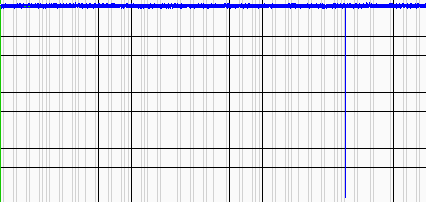

    About the spike that i saw when I measured noise.
    1. I tested it on DC coupled configuration - the spike exits
    2. It last 1 sample
    3. Its power is more than 1000 LSB
    4.; Attached excel files with data so you can check.
    YuvalSpike Ch A.csvSpike Ch B.csv
  • Yuval,
    HSDC Pro displays the numbers as unsigned binary and the csv file is saved as two's comp data. Just add 32k like you mentioned.
    Jim
  • Yuval,
    I do not see these spikes with my setup when using bypass mode or low pass filter mode. Are these always located at the same frequency? Is there some test equipment running nearby your setup that might be causing this?
    Jim
