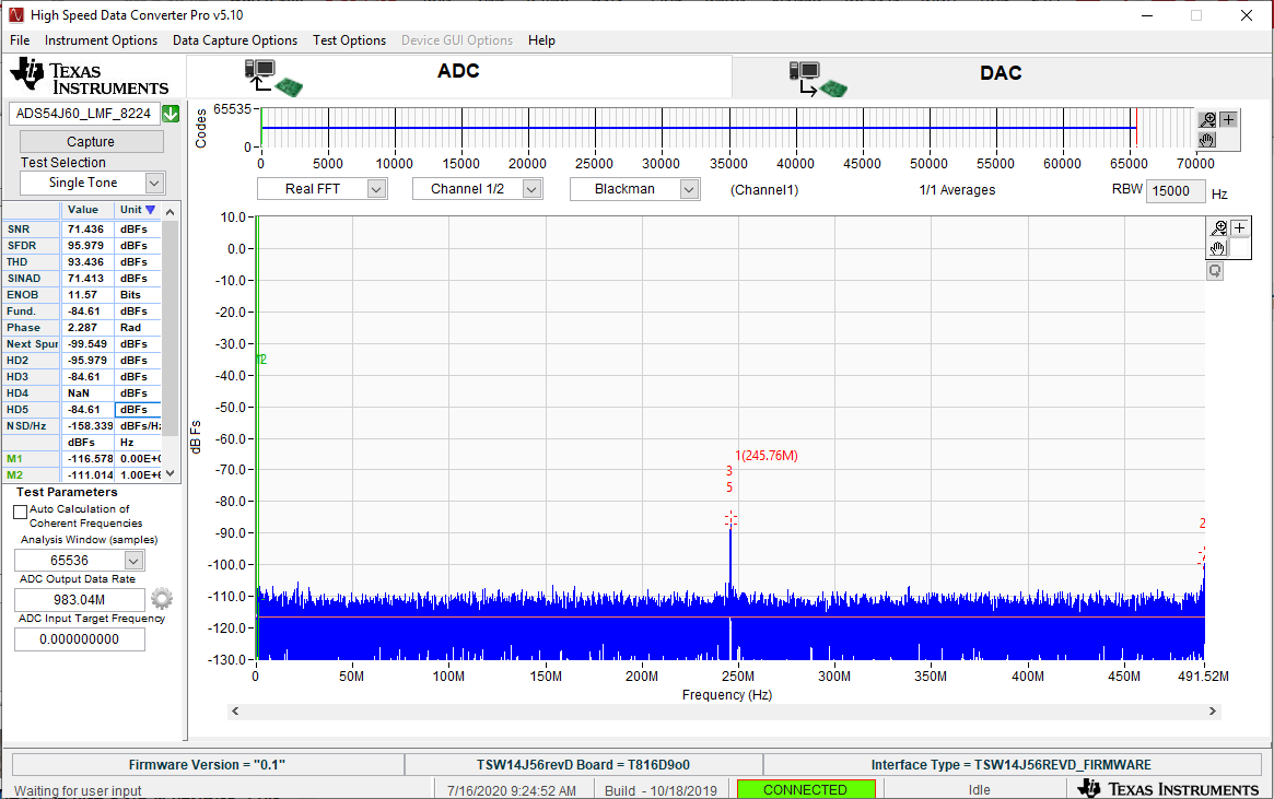

I have the evaluation board of of the ADS54J60 (these are actually 2 boards: one is with the A2D, the other is with the FPGA).
1. I want to test the BER of the ADC using the "ADS54Jxx GUI v1.6" and the "High Speed data converters Pro" programs.
I did not find how to do it. I saw an option to enable the test pattern but did not see any option to verify if all the data arrived correctly to the FPGA or not. I did not find a way to count BER errors.  How it can be done?
2. I saw that in the "High Speed data converters Pro" program, in the "instrument option" tab, under "SERDES test options" there is a way took at the eye and at the side there is a color BER bar. According the color it is hard to say if i had BER errors or not. Is there a way to read the BER counter and not to rely on the bar colors?

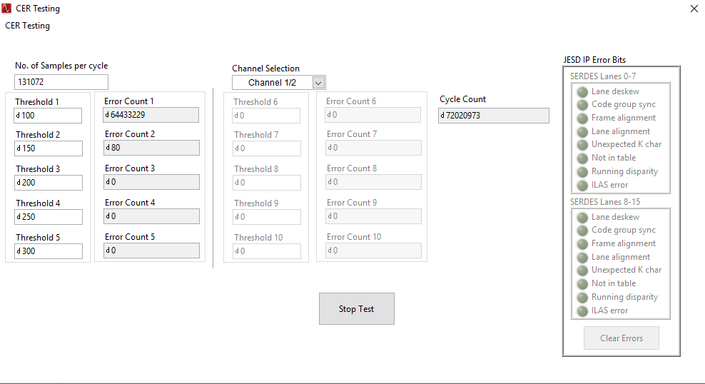

    I tried today to run the CER test but without success.
    here is what i did (please tell me what did i make wrong):
    ADS54J60 GUI Configuration
    1. Configured the clock to 983.04MHz
    2. Programmed the "ADS54J60_LMF_4211.cfg " file
    HSDC Pro GUI Configuration
    3. selected in the ADC drop-down menu the file ADS54J60_LMF_4211_CER (as a sequence it downloaded the FW automatically)
    4. Entered 983.04M in the ADC Output Data Rate field
    5. Reset the board and did one capture (works fine)
    Run CER TEST
    6. I connected a 120KHz sine wave to input A of the ADC (I tried both 1dBm and 10dBm).
    7. I inserted 8192 into the “No. of sample per cycle” field
    8. In the “Threshold” field I inserted the number 100 (i did it only to threshold #1). Is it correct? how do you define this number? BTW, why there are 5 thresholds?
    9. Pressed the start button.
    I got many failures. What did i do wrong?
    BTW, Is there a way to reset the counters without closing the program ?
    Yuval

    This is what I did:
    1. I configured the boards with the ADS54J60_LMF_4211_CER and verified that i can grab a sine wave.
    2. I entered the CER testing window and in the "No of sample per cycle" I entered the number 81920.
    3. I configured the signal generator to 132K, 10dBm
    4. I entered at threshold 1 the value 100 and press the start test.
    5. The error counter constantly increased.
    6. The weird thing is that i tried to increment the value of the threshold but it did not help. I even entered the value 70000 which must give you zero errors but the error counter still increments.
    Please tell me what am i doing wrong.
    Yuval
  • Yuval,
    You must have a coherent input. How are you creating this signal?
    Jim

  • HI,
    I connected the signal generator 10MHz reference to the ADC EVM and the results are much better than before.
    Still, i do not get the results you get.which is zero errors at 100 threshold.
    In my test, i see errors at even 500 threshold.
    I see that your test stopped after 6K cycles. Did you try to run it endlessly and verify no failures after let's say 15 minutes?
    Yuval
  • Yuval,
    I did run for 30 minutes and the results are attached. You will notice I am getting many more errors now. What did you set the No. of samples per cycle on your run? Was your tone the same frequency that I am using?
    Jim
    30 minute run.pptx
  • I am using the same configuration you do. Fin = 276K, No of samples 81920, Level = 10dBm.
    BTW, my results are much worse than yours. According your attached file, threshold = 300 gives you no errors. In my case i need to set the threshold to a much bigger number and i never got no errors when the test ran for a long time.
    I left it running over night and at this case, i got errors even at threshold of 1800.
    I do not know how your algorithm works but i see that the error counter does not increment one by one. In a sudden I see many errors (depends on the threshold level)
    Yuval

  • Yuval,
    In HSDC pro GUI, got to the data capture options tab then select capture options. Change the default capture size to 131072. Go back to the main menu then enable the auto calculation of coherent frequencies and enter 131072 for the analysis window samples. Next enter 277.5k in the ADC input target frequency and set your sig gen to this value. Click on capture. You should see a coherent frequency overlaying the actual frequency when displaying codes. See file attached. Run the CER test and see if your are getting similar results. If not, please send a screen shot of both views.
    Jim
    Coherent Input.pptx

  • HI,
    Still does not work
    1. I do not see the red line as you see it in the graph
    2. I did everything you told. At first it looks like it works, but after some more iterations, i got many failures
    3. I noticed that in the ADS54Jxx GUI, in the ADS54Jxx tab there is an option to set the "En long transport Layer test pattern" (it is under the "JESD Test Patterns" box). When i set it i saw that the register 0x690000 changed from 0x80 to 0x90 and at this case, the CER is 0 (even at d1). . what does this setting do?
    4. I attached some picturesFor TI.docxFor TI.docx
    Yuval
  • Yuval,
    You have to enable the "Overlay Unwrap Waveform" to get the red line. See attached.
    When you enable the long transport test pattern, the ADC generates the long transport layer test pattern mode, as per section 5.1.6.3 of the JESD204B specification. This is a fixed repeating test pattern. As long as your sample size is the same as this pattern or a whole integer divide of this, the CER test should pass with no errors. This appears what you are getting.
    Jim

    2. I saw in the data sheet and also measured by myself the BW of the ADC. I saw that it isn't smooth and have oscillations.. Can you explain the reason of the oscillations.
    Yuval
  • Yuval,
    See attached regarding question #1.
    For question #2, the data sheet looks this way because it is using de-embedding, which attempts to remove the parasitics from the measurement – like balun, pcb traces, connectors etc.
    Jim
    JESD over Fiber.pdf
