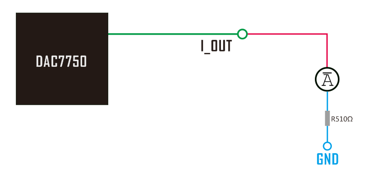

    I can do the read or write action to the 4 DAC7750. Yes, it is DAC7750. I make it wrong before.
    Now I have a question with the DAC-output.
    My config step:
    step 1. Setup the control register to 0x55300D when the device booted up.// REXT-PIN, OUTEN, DCEN, RANG:4~20mA;
    step 2: Set DAC Register: 0x010000, I found the current output is 19.8mA.
    step 3: Set DAC Register: 0x014000, I found the current output is still 19.8mA.
    step 4: set OUTEN bit to zero. The current change to be zero mA.
    The clear pin is Low all the time.  The status register readout is 0x0004.
    I don't know why.
    Our test method:
    Our Schematic part:
    Best regards!
    Beyond
  • Johnan,
    Do the voltage output ranges respond as expected? Though it does appear that you are able to effectively communicate with the device, this would be a nice and simple method to concretely validate that.
    0x0004 in the status register indicates a open-circuit or compliance voltage alarm on IOUT. Did you make any writes to the configuration register? If the APD bit is set then the IOUT is effectively being loaded by a very high-impedance through R95 in your design. I'm not sure why R95 has been included. Maybe a simple test for you would just be to remove R95 without any changes to the firmware.

  • Hello Duke,
             Actually, it is DAC7750. DAC7750 only supports IOUT.
            So I think the scheme designed for DAC7760 is not suitable for DAC7750.

  • Johnan,
    That is a fair point that I forgot about given the subject line of the thread. Still, we could do something similar with an SPI read sequence to verify the integrity of device communication.
    I would still refer to the other points I mentioned in my previous post as I feel they would be meaningful debug steps:
    The only other test I can suggest at this point to get more clues as to what could be the root cause is to switch to the internal current setting resistor to check if there is potentially any solder issue with the external resistor.
  • Hello Kevin,
    I have resolved all these problems by replacing the DAC7750 to DAC7760.
    Is it the key point?
