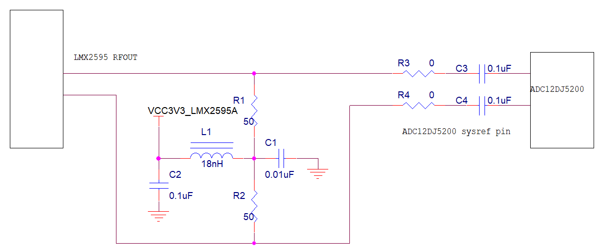

With reference to the design below, the customer has designed the acquisition system of ADC12DJ5200RF+ FPGA + HMC07044 + LMK2595.
TIDA-010128 :Scalable 20.8 GSPS reference design for 12 bit digitizers
The ADC works in JMODE = 1 single channel,16 lanes,jesd204b compatible mode. LMK2595 outputs a 2.5GHz frequency clock and a single pulse form of sysref. HMC7044 sends REFCLK and sysref to FPGA, and ensures homology with LMK2595 input clock.
The initial phenomenon is that after sending sysref to ADC and FPGA, sync can be pulled up in test mode (ramp), but it will be pulled down occasionally. If it is set to normal mode, sync will be pulled down periodically. It seems that there is a problem with the sysref for ADC.
Now, the customer directly grounded the sysref pin of the ADC and only sent sysref to the FPGA. Actually, the link can be established. Sync can continue to be pulled up, not pulled down.
Customer wound like to know why? Does ADC not need sysref to synchronize LMFC when it works?
  • Hi Amy,
    How many pulses is the customer sending from the sysref? It sounds like only one pulse. If that is the case, I would suggest adding more pulses (4 to 8 pulses in a row) or DC couple SYSREF. (I am assuming the sysref is AC coupled).
    Once the LMFC is established the sysref doesn't need to send any more pulse, otherwise the LMFC resets again and again.
    Rob

  • Hi dear,Rob
    The original figure is the following one which I referenced "TIDA-010128 :Scalable 20.8 GSPS reference design for 12 bit digitizers". But when I sent sysref pulse to ADC and FPGA,the sync signal would be pulled down occasionally.
    And then I change my schematic to the following one that the sysref pin of ADC12DJ5200 is grounded directly by DC coupling:

  • Hi Ty,
    See my comments and questions below....
    "But I directly grounded the sysref pin of the ADC and sent sysref only to the FPGA.Then the link was established. It showed that Sync was solely pulled up without being pulled down. RR: okay, understood now., However, you can disable the sysref Rx using Reg 0x29. By default it is disabled, there is no need to pull this to ground and change the circuit.
    But the manual says only when the pulse is sent to both ADC and FPGA  and the LMFC is reset will the Sync takes on such status. How to explain this irregularity? RR: sysref is only needed when two or more devices are going to synchronized, sysref is not required when bringing up the link. Can you tell me the sample rate frequency (2.5GSPS? in JMODE1?) and sysref frequency you are using?
    Or the truth is the link can also be established with sysref pin grounded and the LMFC not reset by sysref pulse?" RR: no, this is not the truth, please see my comments above.
    Rob
