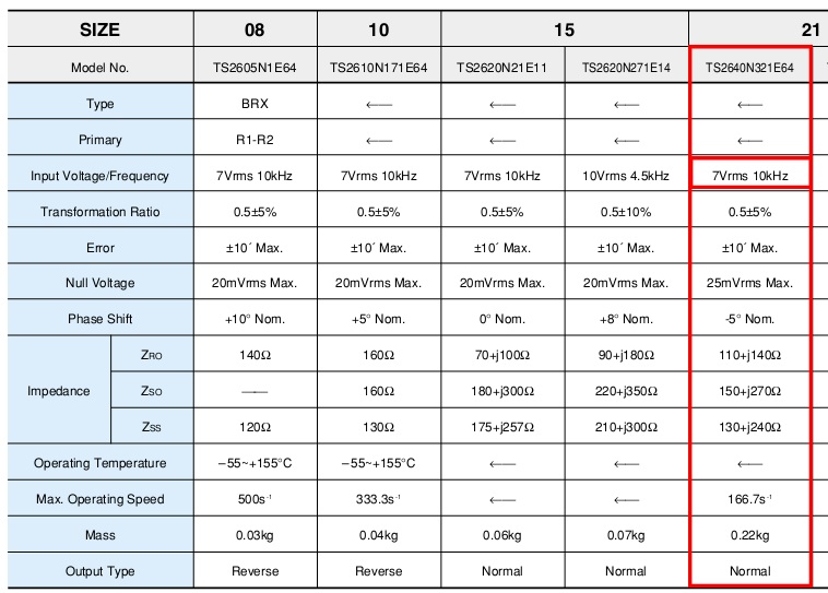

our customer is evaluating ADS1205 and AMC1210 as the AFE for resolver. customer use TS2640N321E64 RESOLVER. the input voltage requirement is 7Vrms as below table. but AMC1200 PWM1, PWM2 pin can only output 5V amplitude signal. it can't meet resolver's requirement. How can we solve this issue? Is a new bipolar push-pull driver circuit needed for every PWM1 and PWM2 output pin?

    One more question.
    as you can see from the table of resolver. the Zro is about 178ohm. but the input signal is 7Vrms about 10Vpp. So the peak current is about 56mA. can OPA1632 handle this current requirement? the Short-Circuit Current of OPA1632 is 85mA(type). what about a simple NPN+PNP push-pull circuit to amplify the output current?

  • Hi Wayne,
    I don't believe the current would be an issue for the OPA1632, but I'll check on that with the linear guys. The transistor option would require two pair to handle the differentian PWN output. Matching may cause some errors/imbalence in the system.
