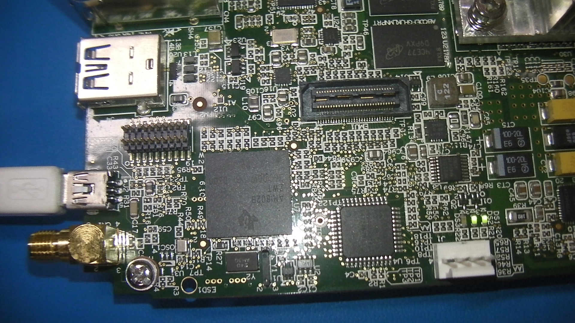

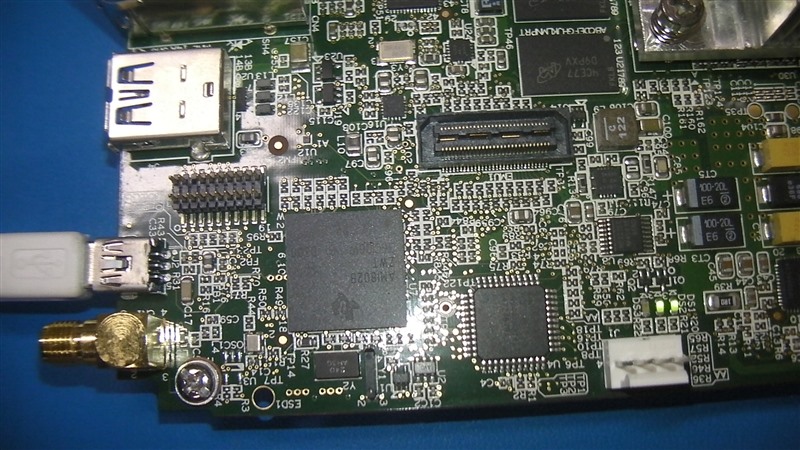

I've got an XTCIEVMK2LX evaluation board and I'm having troubles to make the onboard XDS200 to work. Board itself seems to be OK - pre-flashed applications are running fine. I'm as well able to connect to BMC chip without any problems. Yet I'm failing with XDS200, I've tried numerous USB cables, 4 different PCs both with Linux and Windows, as well as USB2 and 3, but behavior seems to be consistent - enumeration process doesn't seem to start at all. In Linux no message appears in dmesg as well as no additional device appears in lsusb listing after connecting to XDS200 USB port. Similar behavior is seen in Windows - usbview doesn't show any additional USB device, in device manager there is no new (known or unknown) device visible.
As for the board LEDs, when XDS200 USB is connected to a PC DS1 LED on K2L board glows. Both DS2 and DS3 LEDs are off all the time.

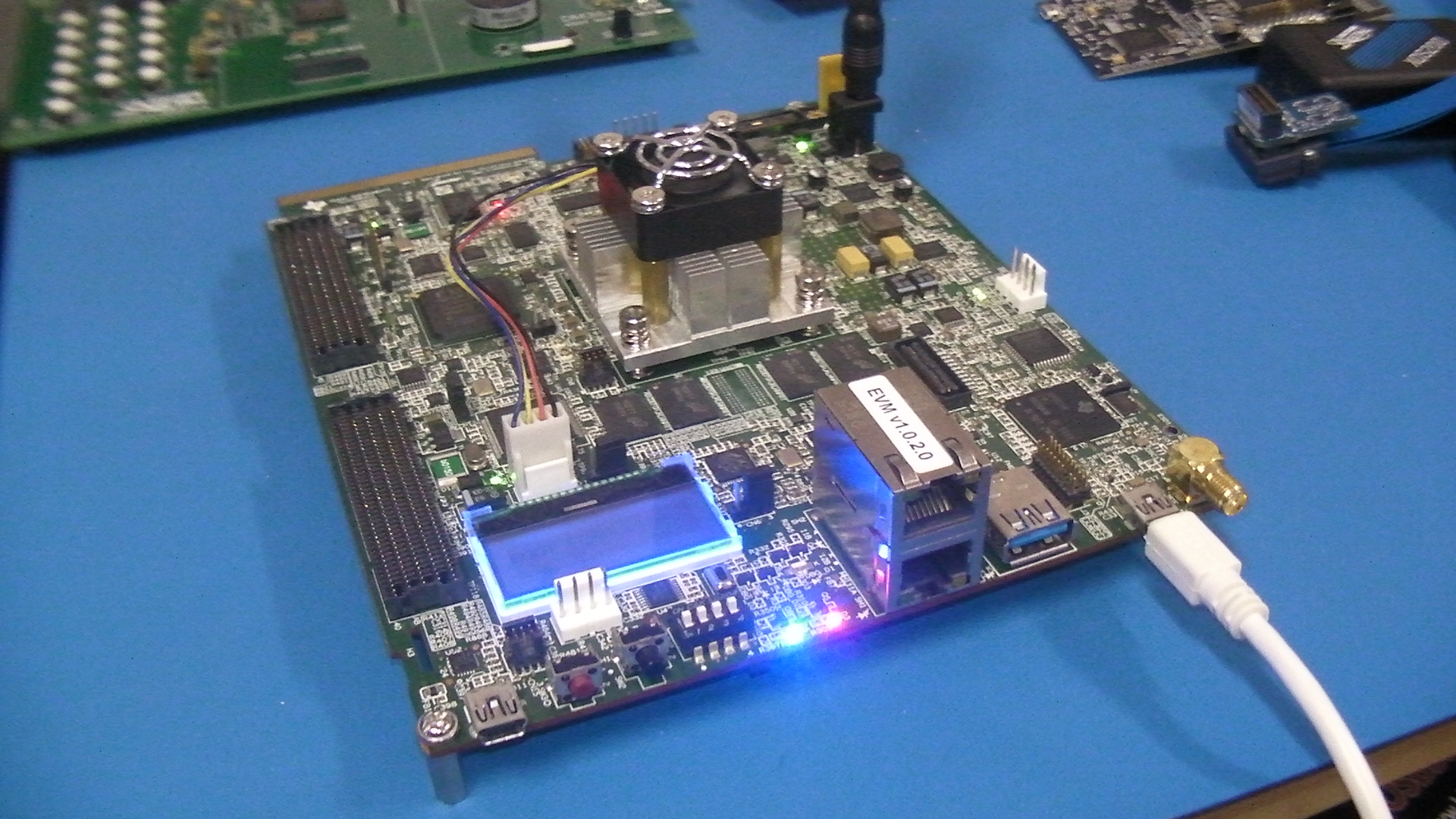

  • Ondrej,
    Just to be sure, are you connecting the USB cable to the USB Jack below?
    When I plug the USB cable, both DS1 and DS2 are lit.
    Therefore I wonder if somehow the onboard XDS200 is either faulty or simply not programmed from the factory.
    Can you use the low-level utility xds2xx_conf shown below to see if you are able to at least get some sort of communications going on? Its location and syntax are shown in the link below:
    http://processors.wiki.ti.com/index.php/XDS200#Updating_the_XDS200_firmware
    If that fails and given that you tested everything else that I could recommend (multiple PCs, multiple USB ports, multiple USB cables) I believe your XDS200 is not programmed and you should issue a RMA with the distributor/company you purchased it.
    Hope this helps,
    Rafael
  • Hi Rafael,
     yes I'm using the USB port as on the picture you've attached. I've tried several PCs, USB cables, USB ports as well as USB3.0 vs. 2.0, direct PC vs. powered hub, but issue is same all the time.
