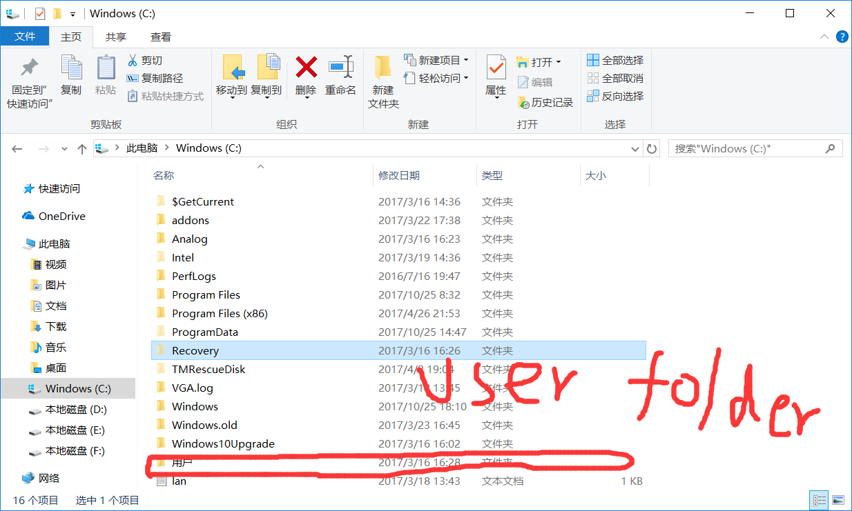

I meet a problem that when I install Code Composer Studio it was always failed.I don't know how to solve it. Can you help me?
It's look like this.My computer is Windows 10.
I have installed three days,I am very upset........

Have you tried passing a different folder location with the --temp parameter like suggused by the error message?
create d:\temp
run ccs_setup_7.2.0.00013.exe --d:\temp
The 7.2 installer has an issue if there are special characters or spaces in the temp path. This is fixed in the 7.3 installer which is available for download.
John
I believe non-ASCII symbols in your user name are the root of your trouble. Beware of spaces too. You might create a user like 'deng_xiaoping', and that should work for you.
