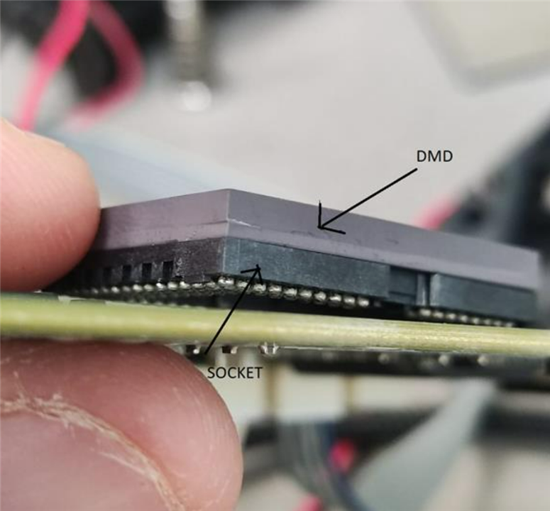

  • We checked and the DMD is soldered bad.  The fail come frome there.  We saw it when we removed the heatsink like yeasterday tell us Ross.  I will prepare the DLP and I will send it back to you to replace it please.

    I've sent instructions on the return process. One final check: you mentioned that the DMD is soldered bad. Technically, the DMD package is not soldered; rather, it has pins which sit into a socket, and the socket is soldered to the board. The reason I make this distinction is because I'd like to confirm that the socket's solder to the board is defective - right? If the issue is with the DMD pins not being properly seated into the socket, then sometimes this can be corrected by removing the DMD from the socket and pushing it back in carefully.
    Perhaps you've confirmed this point already. In that case. please continue with the return process.
    Ross
  • Hi Ross.  Yes, we checked it.   .  We are preparing it for the replacement.

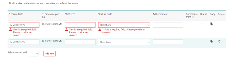

  • Hello Ross,  Can you help me please with the info for the return?  Do you can explain me a little bit better which info is each one of the next questions, please?
    Failure date it's clear.  But the next... I have doubts.
  • Hello Natalia - for the Failure Date, you can enter the date that you started this E2E thread (April 13, 2023). For the other two fields, I am checking with my colleagues for guidance and will get back to you ASAP.
    Thanks for you patience,
    Ross
  • Hello Natalia -
    Regarding the DTC/LTC, it stands for the Die/Lot Trace Code and is typically used to give us a headstart on traceability for the DMD itself. Since your return is an entire EVM, this field is not relevant. Our recommendation is to just submit "NA" for this field. If NA is rejected, perhaps a serial number can be found on the EVM and used for this field.
    Regards Failure code, select something along the lines of "abnormal image" or "defective solder job." Again, this field is not as critical for EVM, especially considering this entire E2E thread related tot he failure.
    Let me know if you have any difficulties or more questions with the form.

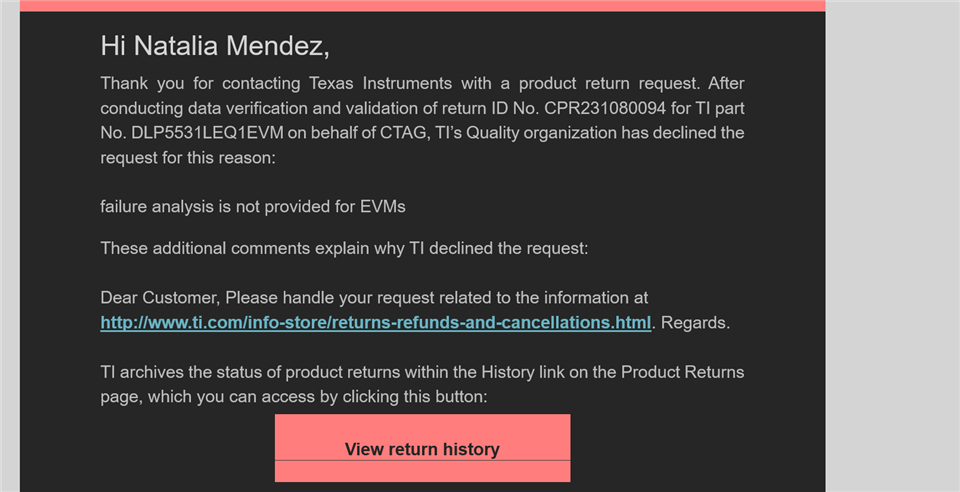

  • Hello Ross,
    TIcancelled the return of the EVM.
    Do you can help me with it, please?  I need to send back to you and close this topic this week, please.
  • Hi Natalia -
    Can you please loop me into the email / discussion? Also, did you provide a link to this E2E thread - it should provide the evidence needed for our Quality Organization to approve this request.
    Ross
  • Hello Ross, I did it this morning.  Lets see what your colleagues will answer us.  I told them that they must speak with you.
  • Hi Natalia -
    Thanks for the update. I have not seen anything yet on my side, but hopefully linking to this thread helps the approval.
    Ross
  • Good Morning Ross,  Anything new?  I need to solve this topic this week.
  • Hi Natalia - we are not in conversation with the Quality organization and are pushing them to approve the return.
    Thanks for your patience, we will keep you updated.
    Ross
  • Hi Natalia - we just received a response from the Quality organization that somehow we are not following the proper procedures. We will investigate further and get back to you as soon as possible.
