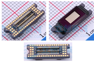

I would like to ask if DLP2021 has multiple package models, as shown in the following figure. If there are multiple model options, which one is recommended?
Hi Kerwin,
The images you show on the left are not the DLP2021-Q1 DMD. This is another DMD. May I know where you found this? This looks like something off of LCSC distributor that has been mislabeled?
The image on the right is the correct DMD and only comes in the S249 package I have previously mentioned in this thread about how to interface the DLP2021-Q1 to a PCB. It looks like that is the image from our TI product page.
