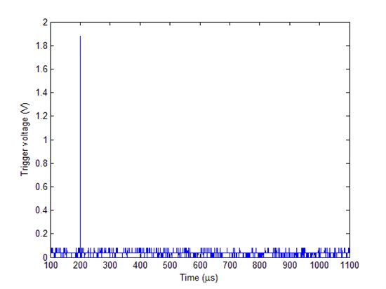

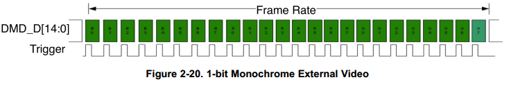

I'm trying to use the LightCrafter in HDMI input mode, with 60 Hz and 1-bit monochrome images selected to get 60 * 24 frames per second. How do I configure the external trigger output to work? Currently, pins 3 and 4 on the trigger connector (furthest away from the side edge of the board) are connected via coaxial BNC cable to a Tektronix oscilloscope. I don't have the scope specs with me, but I am guessing that it has high input impedance.
Based on the manual, I expected to see a trigger signal every frame i.e. ~0.7 ms. However, all I'm seeing is an odd spike at 60 Hz.

p/s: Timing diagram from the manual http://www.ti.com/lit/ug/dlpu004b/dlpu004b.pdf

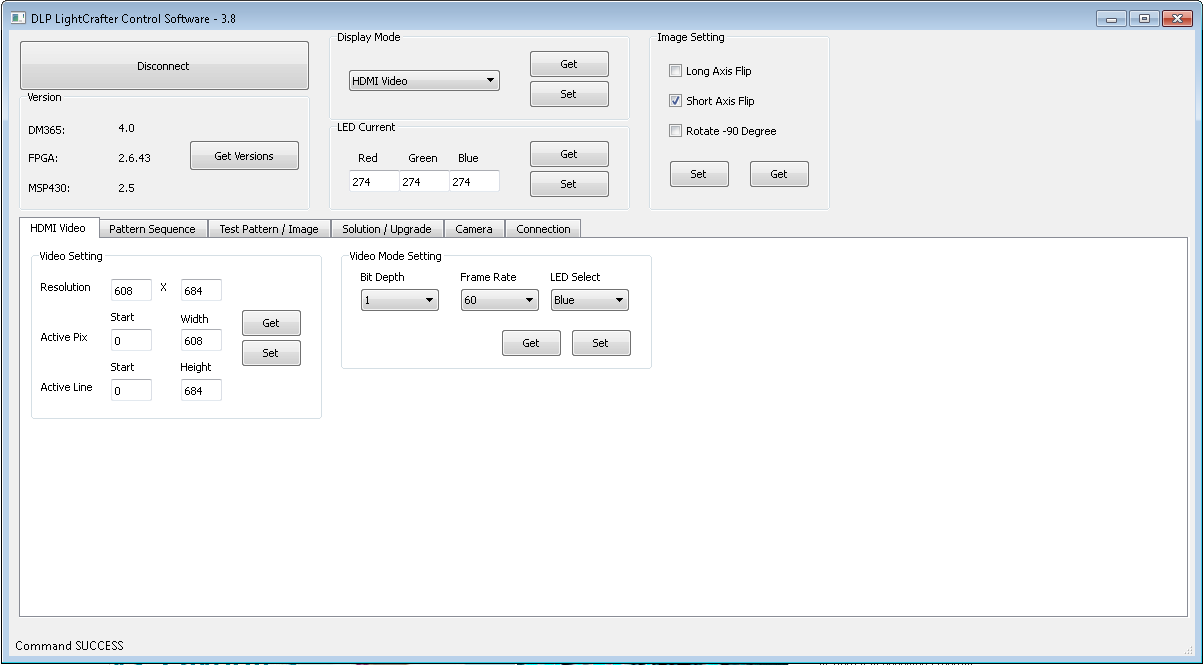

    I would also expect to see a trigger every 0.7ms. Could you post a screenshot of the GUI so I can see your settings?

    Here is a screenshot of the GUI when it is running in the mode we want:

    Downgrading the MSP430 firmware would not have an effect on the trigger. Your settings look correct so I'm going to need some time to see if I can recreate your problem to debug it further.
    Do you have any additional information you can give me about your setup? What is your HDMI source? You mentioned that you removed the light engine, have you modified the LightCrafter in any other way?

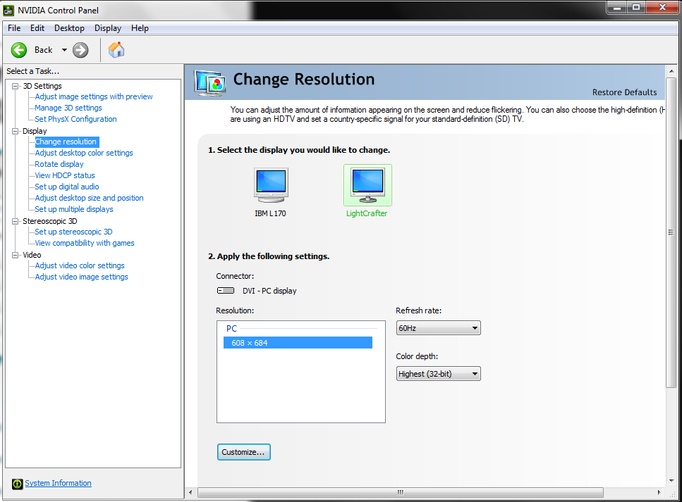

    The video source is coming from a graphics card on a computer. The card is an eVGA GeForce 210. Here's a screenshot of the current screen settings (I don't know why it says DVI-PC Display here, we are definitely using an HDMI cable and port):

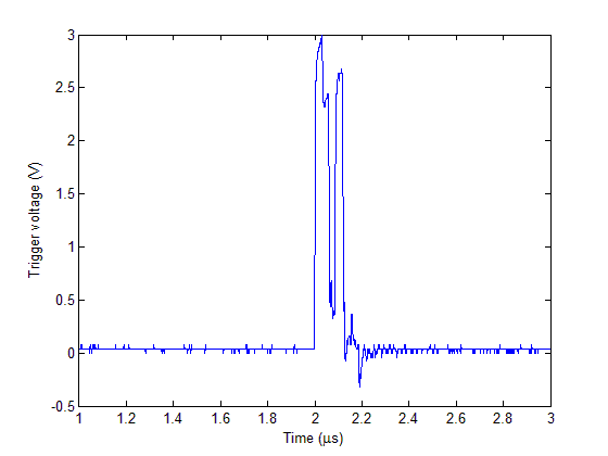

    Here's a plot of the signal I'm getting from the Trigger Out (Pin 3):
    And one with a longer timescale:
    The only modification we have done to the LightCrafter is to remove the Light Engine. We have a v2.0 board and have not added or removed any other components.
    Hope this helps. Thanks again for your help!

    Please change the "color depth" to  24bit and then test. The HDMI Input expects the data in the RGB24 bit format. Your PC resolution shows that you are inputting much higher color depth 32bit.
    Sanjeev
  • Hi Sanjeev,
    Please see my previous forum post and the answer by Pascal: http://e2e.ti.com/support/dlp__mems_micro-electro-mechanical_systems/f/850/t/277110.aspx
    It is not possible to set the video card bit depth to 24. It goes as increments of 8, 16 and 32 bbp.
    However, to quote Pascal:
    I believe that this is correct, though I am not completely certain. I believe that 32 bit color is 24 bit RGB and 8 bit alpha (opacity or transparency). So, for the LightCrafter, 32 bit color should be identical to 24 bit RGB. It just ignores the upper 8 bit alpha channel.

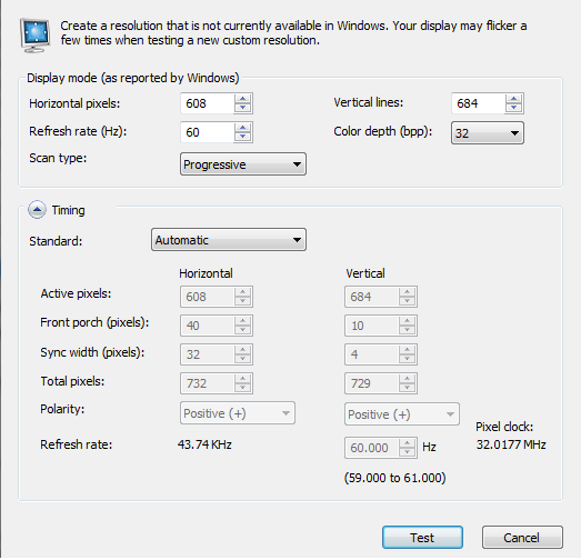

    At this point the only option I suggest you to look at the video timing of the input signal. The max input pixel clock is 33.5MHz please check if it is within the specified pixel clock range. Also you cross check with the Parallel Interface Bus-Timing as specified in Table#8 and Table#9 of DLPC300 datasheet are within the specified limit.

    At this point the only option I suggest you to look at the video timing of the input signal. The max input pixel clock is 33.5MHz please check if it is within the specified pixelclock range. Also you cross check with the Parallel Interface Bus-Timing as specified in Table#8 and Table#9 of DLPC300 datasheet are within the specified limit.
    Based on the settings (see screenshot below), the pixel clock is 32.0177 MHz. Please let me know if the other settings seem right to you.
