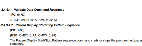

    I have done some looking and it does appear the DLPC350 will not process the incoming video data if you directly go to 'pattern mode' w/ video source. I am current looking for a way we can tackle this issue. Does you system have another controller that could seen I2C commands to the DLPC350?

    I am currently reaching out to the team to see if this functionality will be implemented in the future, and I will update when I know more. The reason it is not current implemented is that difficult to know how long it will take to detect and lock to the video signal. Improper implementation of this can cause unpredictably delayed frames  in displayed data. For now you can try implementing the solution using additional controller. The programmer's guide shows what commands can be sent to the DLPC350. The two that I believe will be useful to you are:

  • Hi Nik,
    At this point, we have no further updates on implementing this functionality.
    The best answer for a work-around would be to have a separate controller which can issue those I2C commands on start-up. Exactly which you choose will depend on your application - but Arduino, MSP430, etc. would likely work well. Unfortunately, as we haven't tried this here, I don't have any further recommendations for you.
