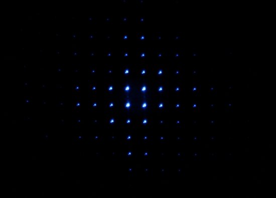

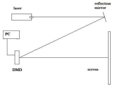

Dear Sir
thank you for your reply for my question,it helps.
i have another question now.Recently,i am on my experience of DMD diffraction pattern.But to my surprise,for the same model 10.8um,12° switch angle DMD,it has two different diffraction patterns,one ,the energy concentrate on the middle point, which means there is only one point very bright . the other, the energe is distributed by the middle two points,which means there are two points very bright. I can not find the reasons,is there any other parameters decide the diffraction pattern besides 'pixel pitch' and 'switch angle'?
ps:i use 405nm wavelength laser
thank you
Hello Xiaofeng,
Would it be possible to attach an image of what you are seeing. It sounds like you may be seeing reflections from the window of the intial incident beam, but I would like to see an image of it to better understand.
Fizix.
Hello Xiaofeng,
First, excellent pictures! That is exactly what I was wanting to see
Now let me ask a couple of questions:
Hello Xiaofeng,
Could you tell me the separation (in angle) between the center of the one pattern and the center of the other pattern?
Also would it be possible to get a picture that shows both patterns in one picture, so that I can see their spatial relationship to each other?
Last, how much of the DMD surface are you illuminating?
Thank you,
Fizix
hello Fizix
the two patterns are independent, they are made by two experiences.(the same experience system, only the DMD changed)
The DMD illuminating surface is the same as laser beam surface.
