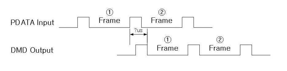

I use DLP3010 and DLPC3438. And 1280x720, 120fps.
What is the delay time between the input end time and output start time?
Hello User,
We immediately display the first pixel at the next VSYNC after Frame 1 is loaded. So there is no additional delay.
The display latency is 1 frame which would be 8.33ms in a 120 Hz system.
