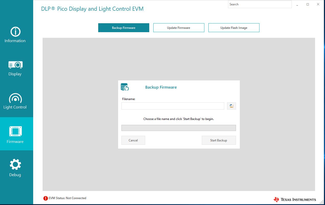

how can I update the Firmware of the DLPDLCR3010EVM-G2 ?
I downloaded the following firmware here:
www.ti.com/.../DLPDLCR3010EVM-G2
DLPDLCR3010-G2-FW:
DLP LightCrafter 3010 EVM-G2 Firmware
Free
Not Available ACTIVE v.1.0.0   26 Feb 2018
The update will always be canceled. I have not done a back-up of the old firmware.
Can you help me?
Max
  • Hello Max,
    It appears you are using our Light Control GUI which is for a different product. You will want to use the Lightcrafter EVM GUI which can be installed at www.ti.com/.../dlplcrd-gui. That should enable you to properly flash the new firmware.
    Kyle

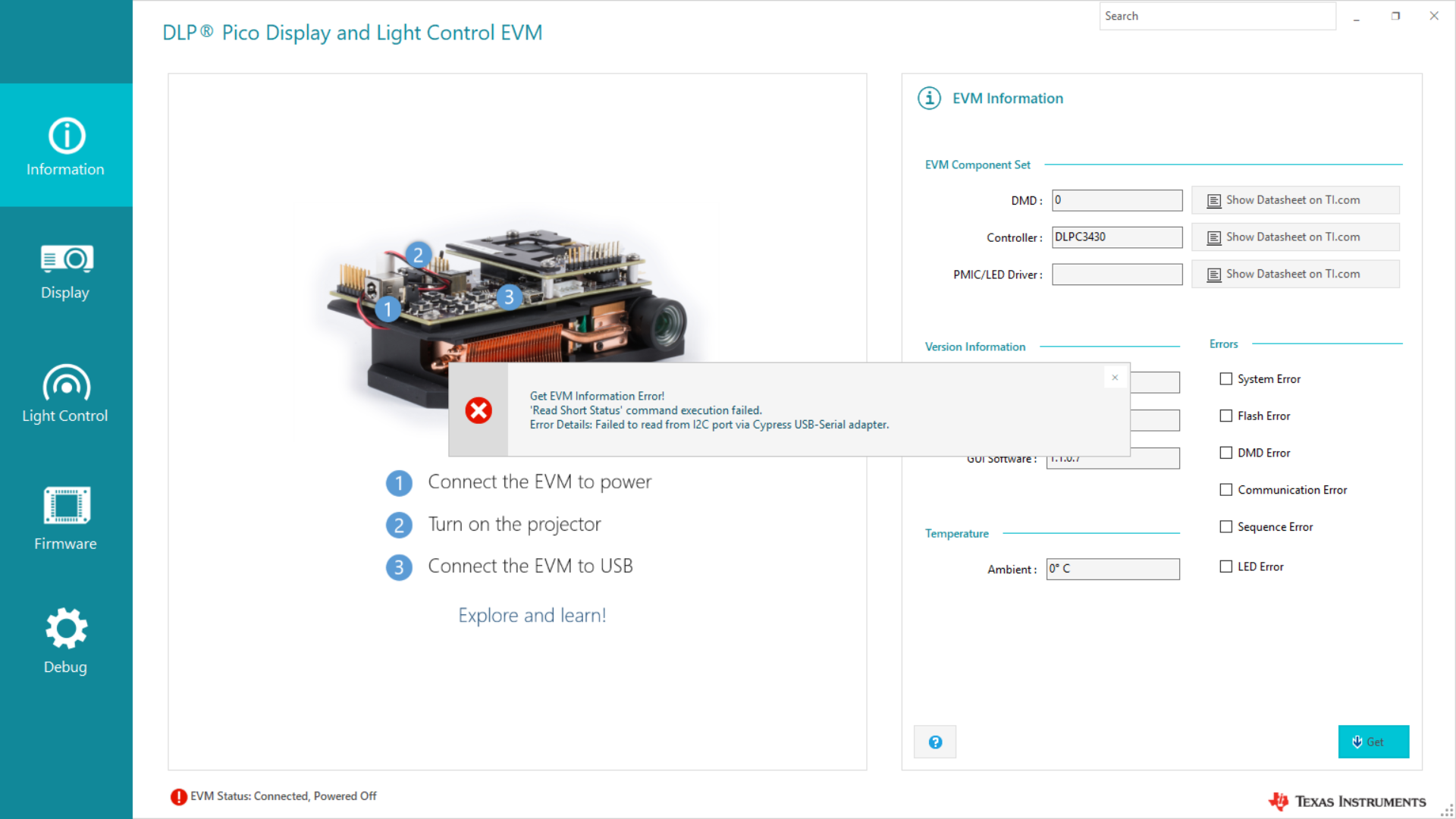

  • Hello Kyle.
    I have now used the Lightcrafter EVM GUI.
    After the firmware installation the following will be displayed:
    The projector is no longer lit and I can not communicate with it. You see here:
    What am I doing now?
    Max Amann
  • Hi Max,
    Looks like you are using wrong EVM GUI.
    By looking at the picture you attached, this GUI is for DLPDLCR3310 EVM, but you need DLPDLCR3010 GUI.
    This DLPDLCR3010 GUI is also available in the same package .
    Navneet

  • Hello Kyle,
    ouh. you're right, we do not have the G2. we have the DLP® 3010 Light Control Evaluation Module.
    I have dowloaded the GUI installer and i wanted to update the Firmware.
    Firmware (DLP 3010 Light Control Firmware) (File-Name after download: "dlpc347x_1.0.0.img")  and GUI installer are dowloaded here:
    http://www.ti.com/tool/DLP3010EVM-LC#buy
    Unfortunately, the following error occurs:
    Whats wrong? How can I update the Firmware and communicate with the Projector?
    Sorry and Thank you,
    Max Amann
  • Hello Max,
    Unfortunately it looks like you are again using the wrong firmware image. If you are using the DLPDLCR310EVM-G2 you will want to use the corresponding firmware and GUI. The link to both can be found at www.ti.com/.../DLPDLCR3010EVM-G2

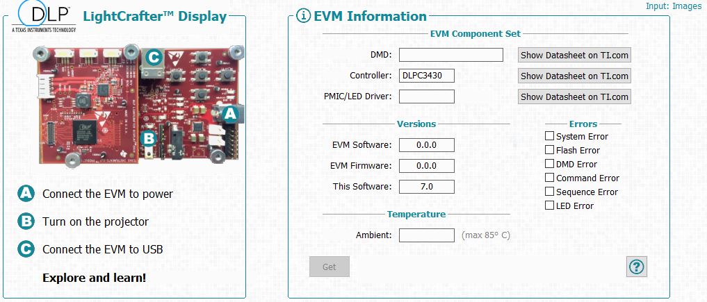

  • Hello Max,
    Here is the procedure you should follow to reflash a corrupted firmware image. Note you will be using the LightCrafter Display v7.0 GUI ()  (this is different than the Light Control GUI you should use during normal operation). This is because the LightCrafter GUI supports updating the flash directly via SPI while the Light Control GUI does not (this feature will be coming later).
    1. Ensure the projector On/Off switch is Off. The switch will remain off during the procedure.
    2. Plug in the power supply
    3. Ensure LED D5 (5V) and D6 (3.3V) are on
    4. Open the firmware page and select update the firmware (use the firmware at )
    5. The GUI will ask if the connected EVM is a 2010/3010 EVM. Select No.
    6. You will get a warning, press yes to proceed
    7. The device firmware will update.
    8. When done you can close the LightCrafter GUI, restart the EVM and turn on the switch. Connect to the device using the Light Control GUI.
    Let me know if that doesn't work.
    Kyle
  • Hello Kyle,
    that worked, thanks! Now I can communicate with the EVM.
