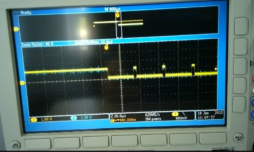

I have connected OV2740 sensor to Appro_DM388IPNC_IMX185 demo board through J1 connector and I writed the iss drivers.
But when the board booting up, it halted at csi2_wait_phy_reset()….

I tested as following:
1. using IMX185 image, connecting imx185 sensor -> everything ok.
2. using IMX185 image, connecting ov2740 sensor or not connecting sensor -> halt at csi2_wait_phy_reset().
3. using myself ov2740 image, connecting ov2740 sensor -> halt at csi2_wait_phy_reset().
But ov2740 board working ok.
1. When power-up, CSI_DX/DY[0-2] is 1.2V LP high.
2. When Iss_Ov2740EnableStreaming(), ov2740 working on . The oscillator output is following….
And I compared ISS and CSI register between test 2(IMX185 image + not connect sensor) and test3(OV2740 image + ov2740 sensor). There’re some difference but none of them is related …..
My question is “What’s DM38x/TI814x CSI2 complex IO reset sequence? Which’s the influence factors?”

    When your data lines and clock line connections and configurations are correct then CSI2 receiver will starts receiving the data with the default reset configurations.
    So pl. check your sensor configurations and the lane connections.

  • For the connection ov2740 to Appro DM388 IPNC though J1:
    Vcc3.3VD------------------------------> ov2740 board power
    SI2C2_SDA----------------------------> ov2740 SDA
    SI2C2_SCL----------------------------->ov2740 SCL
    LVDS_D0P----------------------------->ov2740 MDP0
    LVDS_D0N---------------------------->ov2740 MDN0
    LVDS_D1P---------------------------->ov2740 MDP1
    LVDS_D1N---------------------------->ov2740 MDN1
    LVDS_CKP---------------------------->ov2740 MCP
    LVDS_CLN---------------------------->ov2740 MCN
    EXT_CLK ----------------------------->NC (ov2740 use in board 24M oscillator)
    other pins(IO_1.8V,LVDSD3P/D3N,LVDSD4P/D4N,AFE_RESET,PIC_SDAT,PIC_SCLK,SPI_SDATA,SPI_SCLK,SPI_SEN)---------> NC
    1. For ov2740 board, it works ok when tested using Image Testing Board form DuXin Inc.
    2. For DM388 IPNC, it works ok when connected IMX185,and using IMX185 image.
    For the sensor and lane cofiguration:
    1. Pin Mux. For CSI2_DX/DY[0-4] pins, are used only for MIPI CSI input. So don't need configuration.
    2. For lane configuration, is ok.
    CSI2_COMPLEXIO_CFG(0x5c001050) = 49000321
    Clock position is 1 , Data1 position is 2, Data2 postion is 3 , Data3/4 is not used.
  • to Anand:
    When CSI2 reseting, it will wait for correct CSI2 data..........
    Can you explain in more detail? For example, it will wait for "LP to HS mode transition sequence" or Line Synchronization Packets or others?
    Can I check it using oscilloscope?
  • to Anand:
    I have not checked the CSI2 reset sequence, but i have verified that if the data format and the lane configuations are correct then it will come out of 'csi2_wait_phy_reset()' function.
    So pl. check the lane confguration and the data format in the '..\ti_tools\iss_03_80_00_00\packages\ti\psp\iss\core\src\iss_comp.c' file.
    regards,
    Anand
  • Anand, thanks a lot!
     It's a hardware problem.
    I use a resistance divider circuit , dividing MIPI to two branch , one for DM388, one for oscilloscope. But the circuit not work properly, when I bypass it, the ISS driver booting up, and outputing images.
