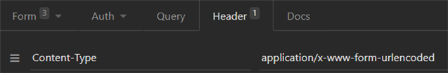

Hi i am trying to login to ti api using insomnia , i have provided my mail id in client id and password in client secret, but i am getting invalid credential error.
I have pasted the error here.
Request to check into this error and provide support for the same.

  • Suresh,
    A few things to confirm:
    1.  Confirm that you are using your v2 credentials (not v1);  You can not use the v2 APIs with v1 credentials
    2. If you are using your v2 credentials with the v2 APIs:
      You may be sending your credentials as a JSON payload, while the API is expecting Form URL-encoded data.
    Details on the authentication requirements can be found at https://api-portal.ti.com/order-api-authentication
    For reference, the body in a sample Insomnia request would look like the following:
    And the header should contain:
    Some additional information:
    • The URL to generate token is https://transact.ti.com/v1/oauth/accesstoken
    • When you pass in “form-urlencoded” payload it should be in this format:
      "grant_type=client_credentials&client_id=<your key>&client_secret=<your secret>"
