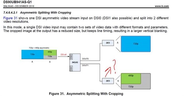

5. If we only use one DSI input, and connect to two different resolution screen, what kind of Des should we choose?

    5. The DES selection should be based on the desired parallel interface. For example to implement OLDI display interface, you could select DS90UB928-Q1 or DS90UB948-Q1. For RGB interface you could select DS90UB926-Q1, or for CSI-2 interface you could select DS90UB940N-Q1.
