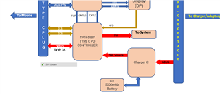

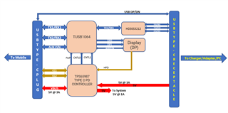

Hi TI Team,
We are developing a device with USB PD using TPS65987DDK as DRP mode(only on the Power role swap mode).
this device shall have a TPS65987DDK and configured as DFP mode initially to source the power of another device (has USB C receptacle) using a USB C plug.
And other times, TPS65987DDK configured as UFP mode, to sink the power from the same device (which has a USB C receptacle) using USB C Plug.
As this PD Controller supports DRP mode, we like to know how both CC1 & CC2 pins are configured.
PD path can source and sink 5V at 3A is fixed and we don't need to do PD negotiation, however, we are expecting this device to control the DP alt mode configuration through the CC pins.
Do we need to use both CC1 and CC2 pins to connect? what are all the different methods to configure the CC pins. Also how we can configure the power paths from Source to Sink and vise versa.
Please let me know if you have any questions.
