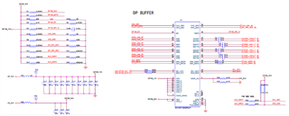

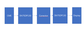

1.This is our topology ,could it be work?
2.Could you help to check this shcmetic , I found that some time have splash screen problem.
    1. I would leave R9 to be de-populated
    2. Please make sure main link and AUX are both AC coupled with 0.1uF caps
    3. Please make sure you are following the power sequence as outlined in section 11 of the DP130 datasheet. VDDD must be asserted first and stable for greater than 10us before VCC is applied
    The DP130 can be used in this application, but the DP130 is a limited redriver with its own TX SWING and Pre-emphasis level that is set base on the AUX traffic snooping. Depends on the actual system implementation, this could cause under or over equalization what can cause signal integrity degradation. I would recommend disable the DP130 link training and manually set RX EQ, TX Swing and Pre-emphasis. For more information, please refer to this app note, https://www.ti.com/lit/an/slla349/slla349.pdf.
    Alternatively you can use DP141 or DP142 for this application.
    David
