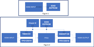

    1) Do we need the EDID EEPROM ?
    If yes, then where we connect because we have refer some of the reference schematic.
    And In the ref schematic , EEPROM is directly connected with DDC line of the HDMI Input(RX side) .See Figure 1 in the below image.
    And other ref schematic, EEPROM is connected with DDC line (SCL_CTL,SDA_CTL) of the Input (TMDS181 ) and output (SN65DP159) ICs and that connection are also connected with FPGA & Clock IC. See Figure 2 in the below image.
     2) Also, How EDID is managed in both TMDS ICs?
    Yamini
  • Yamini
    Per the HDMI spec, all sink shall contain a CEA-861-D compliant E-EDID data structure accessible through the DDC bus.
    For your design, is the FGPA acts as a sink, a source, both, or just pass through the HDMI traffic?
    David
  • Hi David,
    In our case, FPGA acts as a both. In our design FPGA takes the signal from HDMI Input, processes it, and then it passes the signal to the HDMI Output. So for HDMI input, it acts as a sink and for HDMI out it acts as a source.

  • Yamini
    In this case, the FGPA Sink side should have a EDID. The FPGA source side should read the EDID information from the monitor.
    Both the TMDS181 and DP159 only support HDMI2.0, they do not support HDMI2.1.
