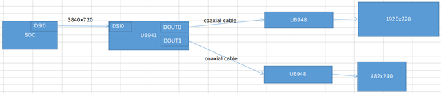

The application diagram is as following:
Superframe( before split)is 3840x720,and the customer referred to the datasheet “8.4.6.4.2.1 Asymmetric Splitting With Cropping" to split and crop the right side of superframe.
He configured the register according to "  RevB_941AS_SuperFrame_Calc.xlsm (snlc064.zip)". But the results are that the panel of 1920X720 could display normally, but  482x240 can't.

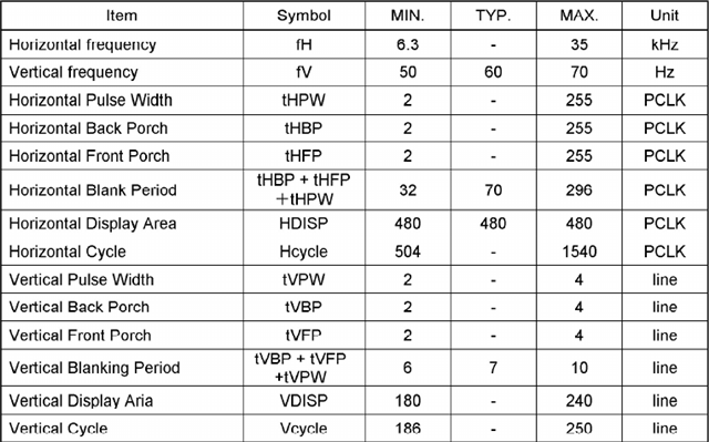

The spec of the 482x240 panel:

    Based on the panel spec provided, there is no way you are going to be able to meet the timing of both of these panels with asymmetric split/crop. That's because when the cropping feature is used, the unused (cropped out) pixels/lines are converted to blanking. In this case, suppose you crop the 720 lines of the full image down to 240, then the unused 720-240 = 480 lines will be added to the vertical blanking of the smaller image (in addition to whatever blanking was already in the original superframe image). Based on the panel spec, the panel has a max vertical blanking of just 10 lines, so this will exceed the maximum spec of the panel quite significantly. There are methods to adjust the horizontal blanking after cropping and remove pixels from the blanking based on REFCLK tuning, but vertical blanking can't be removed. In order to drive these two specific screen you would need to use independent 2:2 mode and provide two individual DSI inputs to the 941AS with each one carrying one of the videos for each panel.
