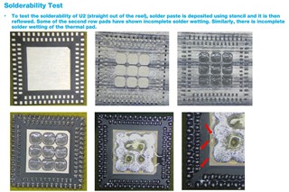

We have soldering issue with the TUSB7340 USB3.0 xHCI controller WQFN-100. This QFN component has dual row on all sides with a large thermal pad in the middle. We have soldering/ wetting issue on the inner row resulting in open. This issue is seen on X-ray inspection and happens on random pads of the component. The yield loss in production is close to 100%. Interestingly, X-ray inspection of BGAs on the same PCB is good.

2. Solderability test of the component pads was done by screen printing solder paste directly onto the component pads & reflowed. It was ensured the pads were not contaminated by handling etc. There is evidence of incomplete wetting on some of the pads on the inner row and the large thermal pad.
Solderability Test
