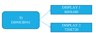

       Do UB941 support  the following design? It seems can't support that, because i can't find register  for configuration such as VFP?   Right ?  Thanks.
        720*720:
    800*480:
  • Hello Chen,
    It is not possible to meet both of these panel specifications in splitter mode since the 941AS splitter mode changes unused lines from the vertical cropping into blanking. There is no way to remove blanking lines when cropping the 3D superframe image so in this case since one of the panels has 720 lines, but the second panel has only 480, then 720 - 480 = 240 lines of vertical blanking will be added to the smaller image after cropping in addition to the original blanking from the superframe itself. That will go well above the 480p panel's allowable blanking based on the spec provide above.

  • Hi Casey.
    Understood. Just a small question in datasheet.
    Why in this picture, it "seems" it could support two different Resolution Display?
    May I ask, if the vertical line are the same, such as 720*480 and 420*480? Could split support?
  • Hello Amelie,
    This statement is incorrect - the 941AS can support asymmetric splitting as described in the datasheet, but it does come with considerations which need to be made on the blanking and video parameters of the resultant videos. The main point is what we discussed earlier in this thread - cropped out video lines are converted from active video to blanking when doing this kind of split. So whether or not a specific system configuration can work depends on the difference in vertical resolution between the two panels and the tolerance of the panels.
    You will find that in the market there are many types of display panels with varying tolerance on blanking parameters and PCLK. Some can tolerate much more blanking than others, while some have a very narrow window of allowable operation. So in this particular case, the panel tolerances wouldn't allow this type of split, but there are other system configurations or panel configurations which can work with this scheme.
    In general 941AS is most suitable for asymmetric splitting cases where the two panels have similar vertical resolution. If there is a large difference between the vertical size of the two panels, then doing a split like this will introduce a more difficult requirement for the smaller panel. An example of a split that would be ideal for 941AS would be 1920x720 and 1280x720, as both the panels have different resolution but the same vertical dimension.
