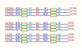

  • The schematics for 241 is not ours, so we do not have it. The 241 board works fine with 124 chip. The schematics for our design as attached. Exactly same as your reference. We tried few different board, few ICs and they all work the same. No higher bits at receiver.

    From the schematic it looks like the default stuffing resistors hard tie HS/VS/DE inputs to GND as well as B5/B6/B7:
    Is this correct?
    Casey
  • All these resistors are removed on our DEV board and external DE signal is fed to all 0..23, DE, VS, HS pins. So all 27 pins are fed the same signal.

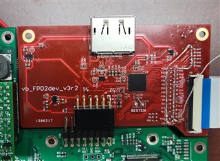

  • Here is the picture of the actual board

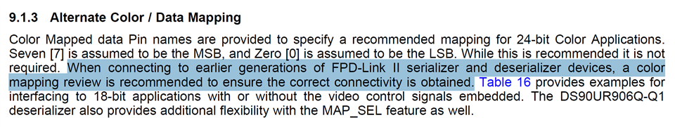

    The input pins R0, R1, G0, G1, B0, and B1 on the UR905 do nothing in this configuration. Any signal applied there will not be passed to the connected UR124. And pins ROUT21-23 on the UR124 will not output anything in this configuration. You are experiencing expected behavior.
    In the provided schematic, you are connecting LCD0 to R0. You need to change this and connect LCD0 to R2. And also make subsequent changes based on the table I provided above.

    UR905 is compatible with UR124. As Justin explained, when pairing the two devices 21 bits are passed from SER to DES which allows you to transfer 18bpp + HS/VS/DE. There is no way to reconfigure whether the MSBs or LSBs of the UR124 are used in this mode. This specific pairing always uses the LSBs ROUT[0]-ROUT[20] of the UR124 so if you want to use this specific pairing for 18bit color you would need to adjust the UR124 design.

    I'm sorry that this situation has caused struggles for you and I agree that this could be made more clear in the device documentation to avoid confusion. In fact, in newer devices such as DS90UR907 this point was made more clear in the datasheet documentation (take a look at table 7 from the UR907 datasheet), but at the time of UR905 release, that was not included explicitly. The UR905 datasheet just makes mention of the fact that color mapping should be reviewed when pairing with backwards compatible configurations for this reason so feel free to reach out to us in the future for support on topics such as this during the design phase.
