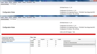

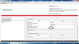

  • For #1: In the project file, in the Transmit Identity Configuration Register enable the bit corresponding to "Device" advertisement.
    For #2: I would require PD logs and the complete compliance report (which I requested earlier also) to investigate.
    For #4: Can you share PD logs along with compliance report? Isn't the manual update of "Connector Type" bits in the Tx Identity register's Header information reflecting your modifications during DiscIdentity process?
  • Dear Kedar
       1. how to set the :The PD test specification has changed since TPS65983B was last certified.. Try to set bits 30:29 of least significant 32 bit value in Transmit Identity Register's Raw Register field view to "3" to match your VIF setting of "Plug".
    2. #1  In the project file, in the Transmit Identity Configuration Register enable the bit corresponding to "Device" advertisement.
    pls the next imge . is it right?
