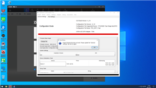

  • Dear Kedar
        I use the TB3_2DP_TI.Pjt  using the 4.14 (gui) . we can't save the pd bin file .
      i get the next errors messge . pls help me to how to use the prj and save the bin file
    thanks

  • Can you share the screenshot of the issue?
  • Dear Kedar
     pls check it : the gui tell me  Project firmware file does net exit ,please update the 'General Settngs " tab and try again
     but i can't find the tab .
  • In the General Settings tab:
    Click on "Change", browse to the Low Region FW binary release for 983B and include it into your project file.
  • Dear Kedar
       Thanks , I have save a bin and create a file to update it . i wil send it to GRL . and then they will give me a report .
