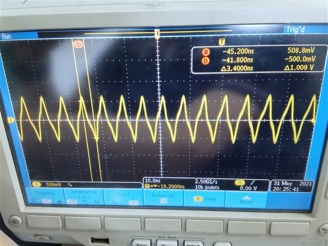

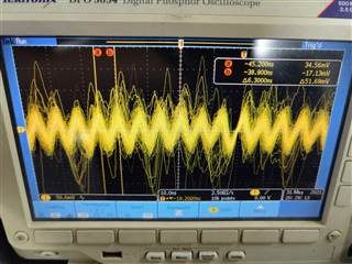

My customer met an issue on SN65DP159 --- the clock outputs are abnormal, please see attached waveforms and their schematic.
This issue happened with HDMI2.0 and HDMI1.4, and HPD_SNK is high when the issue happened.
Could you please help review the schematic and find out if there are any design errors especially the pull up and pull down pins?
And could you please tell customer which pairs of I2C should be used to debug? Thanks.

    Can you please dump out the DP159 Page 0 and Page 1 registers between the good output case and the bad output case? Page 0 registers are in the DP159 datasheet. For Page 1 registers, please write 0x01 to register 0xFF, and then dump from 0x00 to 0xB1.
    Can you also swap the DP159 between the two boards to see if the issue follows the unit or the board?

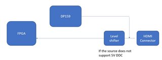

    As for suggestion #3, can I take it as connecting SRC I2C to ground, and connecting SNK I2C from HDMI port to SN65DP159 then connect to FPGA through a level shifter?
    Please see below block diagram for the DDC snooping implementation

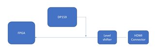

  • Chen
    I made one mistake in my previous block diagram, please see the updated block diagram.
