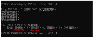

In the case of 100Mbps Jumbo frame transmission, there will be packet loss rate too high in 5000/6000/8972 bytes.
which setting function need to be set and can be improved?

Hi Lucas
The dp83869hm is designed in a media converter (RJ45 to fiber optical)
Uses a PC-A ping a PC-B, and make sure the jumbo frame enable on the PC-A and PC-B.
The blow capture is test result.
Does it need to enable a register to enable jumbo frame of dp83869hm function?

Hi Arthur,
There is no register setting for jumbo frames. Can you read the following registers and tell me their values?
Are any fast link drop modes enabled? Please check each of the fast link drop modes individually (read registers 0x2D, 0x2E). If any are enabled this could cause packet loss.

Hi Arthur,
I don't immediately see an issue from this register dump. Are you using an EVM board or a custom design? If you are using a custom board could you share your schematic for review?
