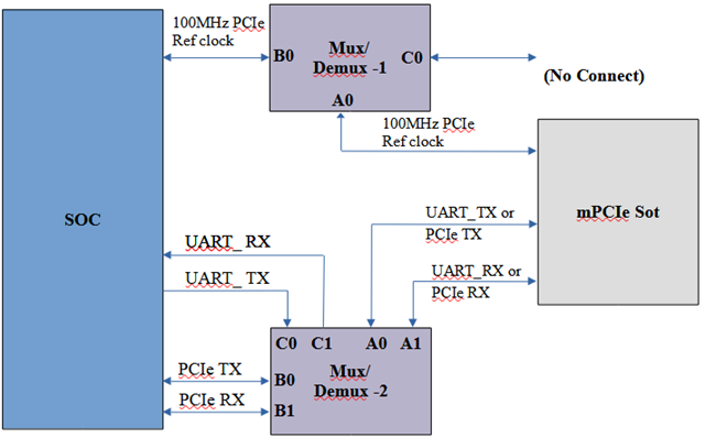

In our custom application, we want to implement a design as shown below:
We want a Mux switch to switch between the PCIe Gen 2.0 Interface and 3.3V UART Interface (or 1.8V UART) between our processor and mPCIe slot.
Do we have any Mux switch which can suite our requirement and tested for PCIe Gen2.0 Interface?

If i'm understanding, you're only looking for mux/demux - 2 which will take the tx/rx of either UART or PCIe at your A port and then pass it through either UART (C port) or PCIe (B port) TX/RX. The max voltage will be 3.3V. What frequencies are you seeing at the TX/RX lines?

Basically we are looking for Mux which can be used for both Mux/Demux-1 and Mux/Demux-2 shown below in the updated diagram.
If we consider TMUXHS4212 (for example), the maximum Recommended Voltage of High-speed signal pins differential I/O pins are1.8V. But in our case the I/O Voltage of UART is 3.3V.
Hence we are looking for Mux/Demux which can be used to switch between:
(i) UART (3.3V) and PCIe Gen2.0 Data Interface.
(ii) UART (3.3V) and PCIe Gen2.0 Ref Clock.

I'm not sure why the PCIe TX_P and PCIe TX_n are being routed through the mux since it looks like they'll always stay the same. Correct me if i've misunderstood that. So currently, it looks like you're looking for a 2 channel 2:1 for both of these.
For Mux1 the frequency looks to be 100MHz so the TMUX1136 will be a good fit. Low on resistane, low leakage, support 0V to 5V I/O, and bandwidth of 250MHz.
What's the frequency of the PCIe TX/RX lines? I know UART doesn't tip over the low <10MHz range. If the PCIe are expected to be the same you can use the same TMUX1136.
Another solution could be to combine mux 1 and mux 2 together in a 4 channel 2:1 mux. TMUX1575 would be a good option. Very high bandwidth, supports 0 to 3.3V.

As Rami suggested, the TMUX1136 or the TMUX1575 can fit this use case. No need for the TMUXHS4212 for this application.
