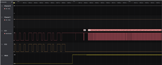

The Problem
Firstly the POR/HR and Detach event data is being sent correctly (see below for Detach data and attachements for both events):
The POR data is considerably long and though it best to send a raw saleae file.

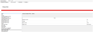

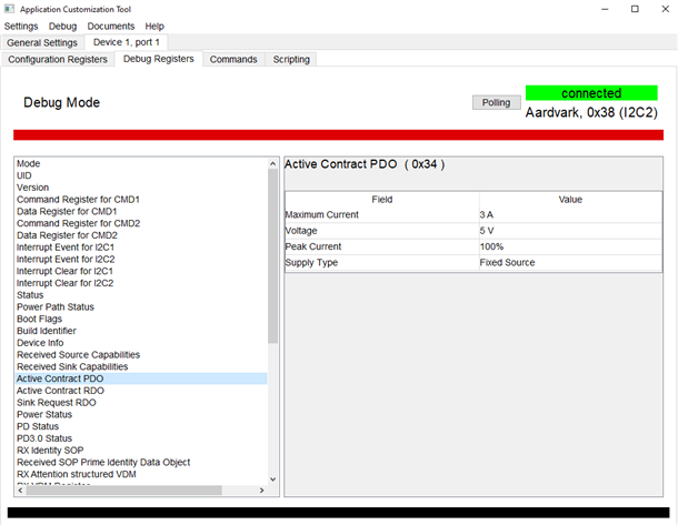

The issue comes when a contract is negotiated. When I enter debug mode on the PD controller, the Contract is active:
but when I inspect the I2C1 line to the charger, no data is sent on this event. Why is this?
I'm pretty Sure I have set up the master events correctly.
I should have attached all the relevant files, if there's anything missing please inform me ASAP.
