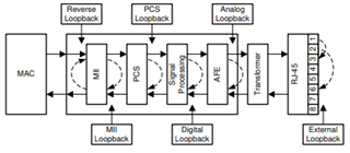

1. Where is the Source of PRBS generator, Before or After MII block?
2.We feel the issue is in MII block or TX & RX bath between MAC & PHY as Reverse Fails, Analog Pass ,External Pass. Agree?

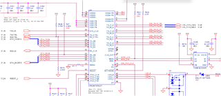

  • Hi Balaji,
    Here are my notes after reviewing your schematic:
    • The decoupling capacitors on all supplies are different from what's recommended. Each 1nF cap should be replaced with a 1uF cap and 0.1uF cap in parallel. To avoid layout changes, you can stack these capacitors on the footprints of the 1nF caps.

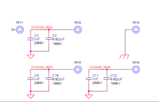

    • I didn't see your isolation between PHY and ERTH GND. This configuration is recommended for best EMC/EMI performance:
    • The 867 doesn't support dual LED function, is this what Q1 is trying to accomplish?
    • Can you confirm your clock meets the datasheet spec? Additionally C427 should be 16pF, not 27pF.
    • I noticed the PU resistor on MDIO is DNP. We recommend a PU between 1.5k and 2.2k, however it seems like you have no issue reading/writing to the registers

  • 1.
    They are connected like this. I dont think this matters. This is from noise immunity during susceptibility.
    2. The decoupling recommendation is not followed i agree.
    The problem is not the design, we have 100 boards which works in the same condition.
    The recent batch has this kind of issue.
    Using engineering principles of similarity and isolation technique-this is not the root cause.
    if so why only reverse loopback fails?
    3.Q1 is Do not install, so i wont worry about it.
    4.We have tried bypassing the filtering caps and still have the same issue.
    Except phase noise- we are confident the oscillator meets the phy requirement. We are trying to use an alternate with phase noise spec of 11ps,
    5.MDIO has no pullup externally, but if you see TXS0102DQER onthe sheet it has internal 10K ohms pullup. and the failure is not while accessing MDIO lines
    6. CKOUT follows 25Mhz-i see no issues.
    We have not probed RX_CLK.
    MDI clock pulse is okay.
    7. We have not tried clearing bit 7 of 0x0031 because its same for passing and failing board and the link is at 1gpbs. but we will attempt it.
    8. Can you tell us the source of prbs geneartor?
    9. we need to answer why reverse fails and external passes. thats where the clue is

    The PRBS generator is located after the PCS block.
    I just want to confirm, you're talking about reverse loopback and external loopback as seen in this figure?

    yes correct i did the external loopback and reverse loopback as in the figure

    Can you provide more details about your reverse loopback setup. What is the link partner used? Is the link partner generating packets and counting packets when received again?
    Can you provide more details about your external loopback setup as well. Is the processor generating packets and counting for errors when received back? What is the MAC interface used? Register 0x10 is showing SGMII and a mismatch in RX/TX FIFO depth. Was this intentional?
    We sent packets from other network device we designed and count the packets sent and recived.
    Good and Bad boards pass.
    Yes external loopback sends packet and receives it and matches the count.

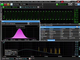

    Above is the phase noise and Jitter data.(non working)
    I know that the pHY wants rms phase noise to be <11ps.
    We have the dbC/Hz plot. Can you verify it?

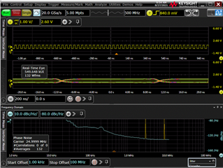

    The reason is, on the failing board we replace the board with different set of oscillator .
    Below is the good oscillator on a working board:
    We could see that the jitter is on the higher end on the non working one but we are unable to make a decision if its the jitter because the phy quotes only RMS phase jitter(phase noise) in ps.
    Can you help?

    1. We could see the failure follow the oscillator. When we change the oscillator the failure goes away.

    1. we are looking at phase jitter rms which we suspect

    Phase Jitter RMS Values
    Faulty board from new batch: 239.4ps
    Good Batch Oscillator: 49ps
    Alternate part from ASDDV series:3.192 ps
    Phy Spec:11ps

  • no issues when using a good oscillator which had phase noise of 49ps even though the phy told its is 11ps.
    Problem occurs when we use a oscillator which has phase noise of 239ps.
    can you tell what exactly will get affected because of phase noise?
    I know period jitter pk-pk affects the setup and hold margin but could not think of what is inside the phy
  • Hi Balaji,
    The XI clock is the reference clock for PHY, so jitter in this clock results in jitter for transmit and receive clocks of the PHY as well as a degraded SNR.
    Does this answer your question?
    Thank you,
    Nikhil
    All information in this correspondence and in any related correspondence is provided “as is” and “with all faults”, and it is subject to TI’s Important Notice (http://www.ti.com/corp/docs/legal/important-notice.shtml).
  • can you elaborate a little more.. please tell me numbers. what margin am i violating if have 49ps instead of 11ps? Ethernet phy validation test? SNR Of what? RGMII side or Differential ethernet side?. What is the SNR of the Ethernet Differential Signal? SNR Of Digital bits is not applicable because its not modulated and is VIH-VOH or VOL-VIL =noise margin and clocks dont affect it..
  • Hi Balaji,
    This will affect the MDI signaling. Though our datasheet specs 11ps jitter, you seem to be ok with your clock having 49ps, correct? Some tests you may conduct on the transmitter end are the IEEE PMA Compliance tests, particularly the jitter tests. If all tests are passing, there may be no issues on the transmit side. To check the receiver side, you may do a link up test.
    Please let me know if you have any further questions.
    Thank you,
    Nikhil
