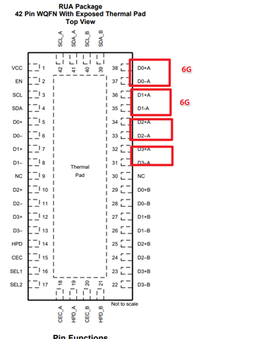

Port A support 6.9G, does it mean D0± can support 6.9G, D1± can support 6.9G,D2± can support 6.9G,D3± can support 6.9G? or just mean D0±,D1±,D2± and D3± total could support 6.9G?

Please see section 6.6
The BW applies to all channels.
