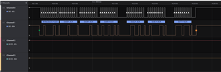

Symptoms:
There is no issues related to I2Cr and I2Cw but no longer charging battery.
But battery was charged well in default even without any settings when the patch bundle after generating with the previous version 7.0.1 was downloaded successfully.
Captured:
I2Cm_SCL and I2Cm_SDA lines
captured.zip
Questions:
- Should I write the Full Flash Binary on my test board to use things of the version 7.0.2 ? I used to use the Low Region Binary until now.
If so, how to do that?
  • 0647.captured#2.zip
    I attached a new captured. Ignore the above captured.zip.

  • JK,
    I am in the US Central time zone.
    I have reviewed the changes made from the 7.01 GUI to the 7.02 GUI and none of them were expected to impact the charger.
    Are you able to monitor the I2C bus that connects the I2Cm of the TPS25750 to the BQ25792?
    I would like to be able to review the control traffic between the two devices in your system and compare it to one of our reference designs.  I do not have the equipment to mimic a battery easily accessible to me, so the best I can do is review the control traffic between the 2 parts to see what has changed between the 2 revisions.
  • JK,
    I am working with the GUI developer and the firmware team to look into what is happening here, but I do not have any current updates today.
    I have a Reference design in my possession to test with, but do not currently have it up an running.  I will be working on this first thing tomorrow morning.
    Chuck

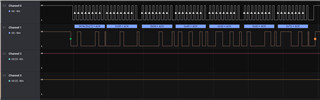

  • Hi Chuck,
    I attached some captured data to I2C signal. See below please.
    If you don't mind, I would like to send and receive feedback in real time by extra communication channel like skype, etc.
    My skype ID: linorise0904
    So I'm sure I can send immediately that you need things.
    It's really urgent to me so I ask you.
    Battery Charging Issue by 7.0.2 v02.xlsx

  • JK,
    The patch bundle should be loaded on the I2Cs.  The charger interface is on the I2Cm bus, so there should be no contention.
    The method that we recommend to control the BQ25792 is the use the I2Cw and I2Cr commands to access it through the TPS25750.  This would give you independent control of the ICs.
    I am currently debugging the issue that you are having because I feel that it is related to other customers as well.  I should have an update for you in a few hours.
    Chuck
  • JK,
    I have confirmed that we have introduced a bug in the 7.02 GUI that we are working to patch currently.
    I will update you once I have a new GUI release tested.
