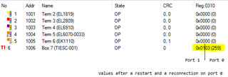

some time ago there was a discussion because of the link lost counters.
The counters of port 0 and port 1 were incrementing by one after restarting (power reset) the device.
e2e.ti.com/.../dp83822h-ethercat-conformance-test---link-lost-a-b-counter-reset-behavior

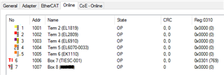

Another scenario came up doing a reconnection after a EtherCAT communication has been established (unplug and plug network cable of the slave device). In this case the counter of the used port is incremented by two, The increment of both link lost counters after a power reset was justified because of the PHY reset that is initiated as start of application.
Do you have any idea why the counter of the connected port increments in case of a reconnection? There should be any other reason.
I am using the "EtherCAT Full Feature Demo Application" from the "PRU-ICSS EtherCAT Industrial Package" on the AMIC110 ICE EVM.
