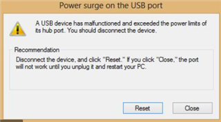

    Also i have this problem when i connect HUB to usb at PC(power form PC is not used, it can be seen at schematic i uploaded):

  • Every overcurrent pin (except those which are not used) are high. I think the problem is when hub is not configured (not connected to pc), when i connect hub to host all PWRON go low.
    But still i have problem to connect hubs to usb host. When i connect usb to pc, pin HUBCFG go high for 3 seconds and then computer prompt the message i attached above(about power surge), then HUBCFG go low and SUSPND go high. I checked voltage on VBUS and it is 5V all time, even after error message. I have 3 PCB with 2 hubs each and every PCB behaves the same way. I tried this even in other laptop - same problem. The strange things is, 5V rail from USB host is not used, because BUSPWR is high. There is only TVS and i even desolder TVS so VBUS is attached only to usb connector. Maybe this description helps you to figure out what is going on.

  • Can you check that the OVERCUR pins on the unused ports are not pulled low?  If an overcurrent input is low anywhere on one of the hubs, it will report the event to the host and the host will disable the hub's downstream ports.  That sounds like what is happening.

    Unused port were floating, so there was 0V on those pins. I do some soldering to pull-up OVERCUR pins, and after this changes all OVERCUR pins are 3,3V and there is no more error. I thought that hub which isnt in ganged mode has no problem with unused ports error but it sure has.

    Yes, the hub reports the overcur status even on the unused ports because the hub doesn't know which ports are used or unused.
