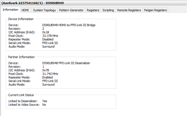

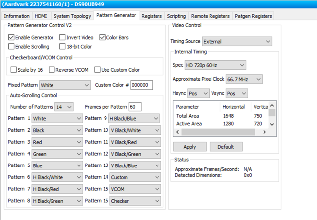

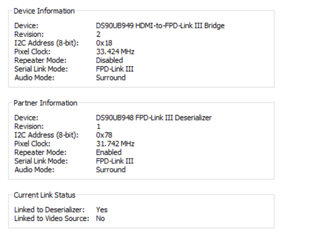

I'm using a custom DS90UB949 board with a DS90UB948 EVM board. I got the 949 and 948 Evaluation kits to work over HDMI. When I try the same register setting for my custom 949 board, the pattern generator works but the HDMI input does not. No issues with hardware. VTERM is 3.3V, the differential pairs are connected well, 5V HDMI signal is detected, INTB and REMINTB are pulled up to 1.8V, DDC pulled up to 5V.
