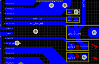

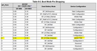

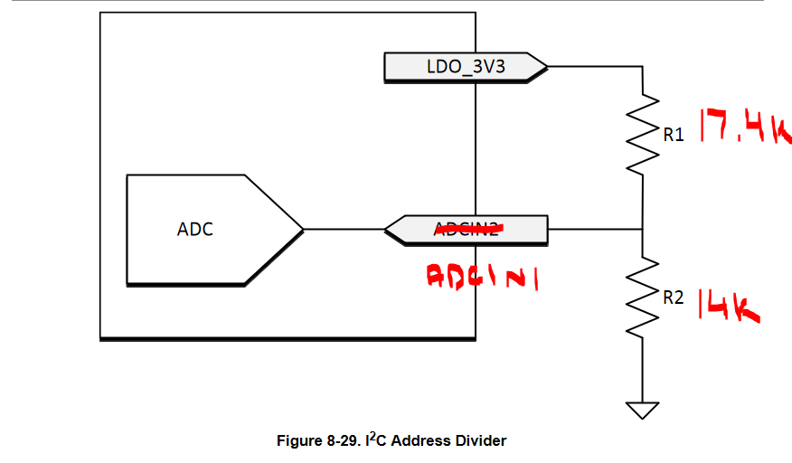

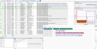

Hi, I have a chip set for configuration 3 in dead battery mode and I can see in the debug registers that it has a PDO for 20V but it won't negotiate the 20V with my PD charger.
I've ruled out the PD charger because I have a tps25750 that can successfully negotiate 20V.
When I plug in that USBC to the tps65987d I do not get 20V but instead 5V 1.5A only
