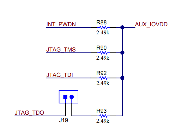

Hello Ranjini,
Please see below for supply decoupling and JTAG. Place a 33 pF parallel to the RBIAS resistor (R429). This improves device performance specifically during compliance testing.
Sreenivasa

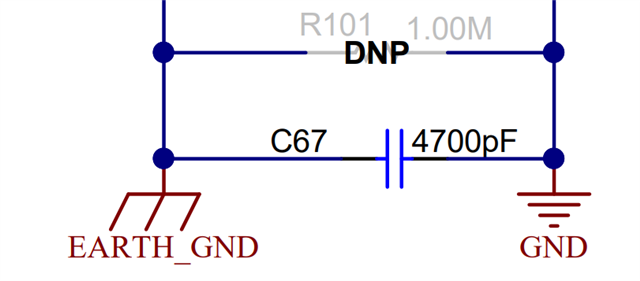

Thank you for the inputs.
I'm using 2 DP83869HM. In RGMII to Copper & RGMII to SGMII bridge mode (the feedback points are implemented)
Can you please have a look at the attached design.
Ranjini.R7673.ETH.pdf
Hello Ranjini,
Thank for sharing the schematics.
I did a quick review to support the project timeline,
I have embedded the comments in the schematics. Placing a cap between shield and the circuit ground as shown below is recommended. A mounting hole to connect the shield to external ground is also recommended.
