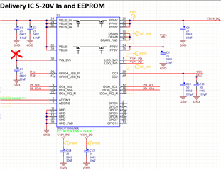

TPS25750: PP HV shuts off after a small amount of time
Part Number: TPS25750
Other Parts Discussed in Thread: BQ25792
Hi, I have a tps25750 configured to negotiate 20V sink without using the external EEPROM and it seems to negotiate reliably.  Downstream I have a BQ25792 with a battery load and a system load.  When functioning correctly, I see ~25W of power provided to the battery and system over USB C power which is exactly what I wanted.  However, after maybe 20 minutes or so, the FETs open on the TPS25750 and I lose power to the system.
See schematic below (note: my 3.3V LDO is not powered up in the system right now so I'm relying on 3.3V being supplied internally in the tps25750 part)
