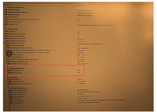

We use TI's master chip XIO2001 to design a pCI-PCI board. The attachment is the circuit diagram of the board.Now the debugging fails, and the fault symptoms are as follows:
1. A network card (model: TG-3269C(TP-link)) is inserted into the extended PCI slot, which cannot connect to the external network or communicate with other computers on the internal network;
2. In the device manager of the system, XIO2001 bridge device and NETWORK card TG-3269C can be identified normally, and the driver has been installed;
3. IP addresses have been assigned to NETWORK adapter TG-3269C in the system.
4.the schematic as below
