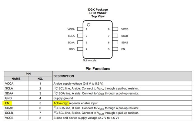

Part Number: TCA9617A
Hi Team,
EN pin is internally connected to VCCB through a pull up resistor, does it mean that we can let EN pin floating if we want to enable the device all the time?
Is there any risk to let EN pin floating?
