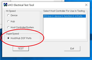

    If XHCI HSETT is absolutely required, I would like to know the suitable usage.
    What should I set after downloading XHCI HSETT?

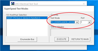

    [A2] There is only one option for SuperSpeed:
    Select the hub in the left window and test mode / port on the right and press execute:
    [Q3]
