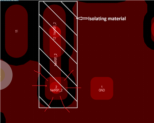

I have 2 custom boards. One working Ok, other sgmii connection very unstable.
Linux  ethtool -S eth0  show fcs errors.
After investigation, I  found cause of not stable sgmii connection via sgmii.

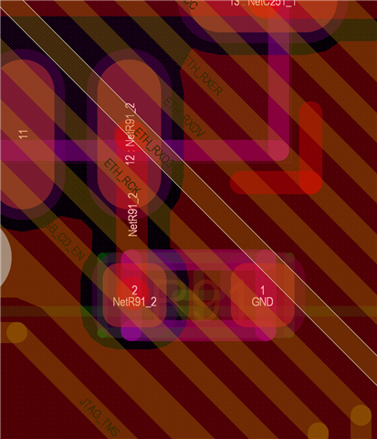

Cause was very small parasitic capacitance between RBIAS copper solder plane ant RGMII data lines planes at second layer. See picture:
To solve this problem need  DE soldering chip and rbias resistor, isolate chip rbias contact, connect rbias copper plane to gnd(use as shield), and solder rbias 11k resistor  directly to chip rbias contact and GND.
This tested and working Ok, but some difficult.
Possible light solution. Connect in parallels rbias resistor, 33pF  capacitor. But not all noise avoid.
What can I use biggest capacitance?  Is ok 0.1uF capacitor ?
I not found in application notes warnings about rbias sensitivity.  Only - "rbias" must be close to chip.

  • >>Has the root cause of the issue truly been identified as the unstable RBIAS signal?
    Yes its truly. I am sure 99,99% Slight smile.  Our old custom board (version 1) don't have this issue, because rbias plane was shielded  with internal GND planes (not special).
    It seem to me, that this issue need insert into  troubleshooting guide. I lost 2 weeks to solve this problem. RBIAS copper plane must be GND shielded from second layer.
    We try with a parallel cap to RBIAS 33pF,  220 pF.  But these tests did not help us. We got  fcs errors, when do ping test with 10000 bytes packets from 2 terminals windows.

  • Hi Nikhil,
    >>Can you elaborate on what is meant by "RBIAS plane was shielded with internal GND planes"?
    Our boards is multilayer ( 8layers).  So in old board version 1  between RBIAS copper plane and eth data signal layer exist GND plane(polygon). So this board don't have issue.  Board version 2   eth data signal layer are on second layer. This board have issue. Layer thickness 0.125mm.  Rgmii signals are 3.3V  ~25Mhz (fast rising, fall signals ).   We have her small parasitic  capacitance (maybe 1pF)  between  RBIAS copper plane and eth signals.  So we have capacitance divider - parasitic capacitance and rbias input capacitance(maybe 10pF).  In result we got noise on rbias input.  Only "GND shield" between rbias and eth signals can help.  Additional capacitance 33pF or 220pF in parallel to RBIAS not help.
    >>Are you checking for errors on the MAC side or the PC side?
    We using DP83869HM  as bridge, sgmii on PC (embedded linux with sgmii interface) side, rgmii mac on  micro controller side. So I checking FCS errors on PC side, with command "ethtool -S eth0" on terminal console  and doing "pings" from 2 terminal consoles (PC side).  So I have 3 test consoles.  This setup simplified my test.
    I try find and read "errors registers" on DP83869HM. But they not show any errors.
    Image1. show linux console fcs errors if use board version 2. Fcs errors not show on old board version 1.
     >>We do not have any special via configuration for connecting RBIAS to the GND plane and have not seen this issue before. The screenshot you have shown looks ok.
    Because rbias is very sensitive part, it seem to me, that rbias resistor gnd must be connected to  DP83869HM  GND PAD with dedicated track (signal GND). I see, that this point can be make ease,  with  thin track on same layer through the corner of chip. This avoid gnd common mode noise (CMN). And rbias signal pad must be "gnd shielded"  from other signals.   "gnd shield"   must be connected at 1 point  through  via to DP83869HM  PAD (avoid CMN noise on shield).

  • Hi Sreenivasa,
    Our board is 8 layer.
    In picture you can see 2 layers (component  and  second (next) internal layer). I disabled others layer for better view.
    After our modification (isolating 12 chip contct) NetR91_2 polygon became isolated and we it routed to GND poly. (It became shield) .
    Rbias resistor R91 we solder on air between  12 chip contact and GND.
    B.R.
    Darius

  •  I append picture with only component layer.
    To avoid parasitic capacitance between  rbias and rgmii  signals,  need insert gnd plane between ( NetR91_2 )
  • Hello Darius
    Thank you and understand. Pin 12 is now floating and you are connecting to the resistor externally.
